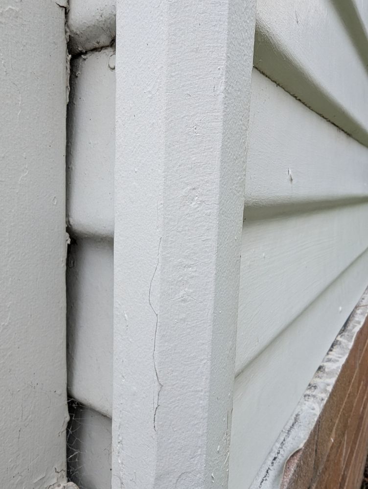

I have a couple of timber corner trims on the outside of the house (late 60's Fibro) that have rotted at the bottom and need replacement, but I can only seem to find standard right-angle corner trims. This house's corner trims look to be about 10mm thick and have a 45 degree cut where the 2 sides meet so it has 3 equal faces.
Does anyone know what these are known by and where I can get them?  I like this style much better than the generic 2-sided ones.

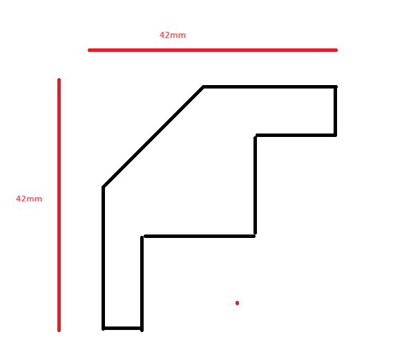

I've drawn up a basic pic of the cross-section (best I can do without removing it)
What would you recommend I try if I would have to fabricate my own?
Cut the maroon cuts first from a square ended 42mm piece of timber.
Then cut the Blue cuts leaving the last (diagonal) cut until you are happy with the back side profile.
I would practice on some shorter pieces first until you are confident of ripping the timber for a full length/height. Ity may seem daunting (the first one will be terrifying) :smile: but the accomplishment you feel when you have done it will be worth it :smile:
As a hardness level working with timber and a circular saw with an adjustable foot, ripping and clamping it in place. Id say a 8 out of 10.
If you have a saw table, then I would say the hardnes swould drop to a 5.

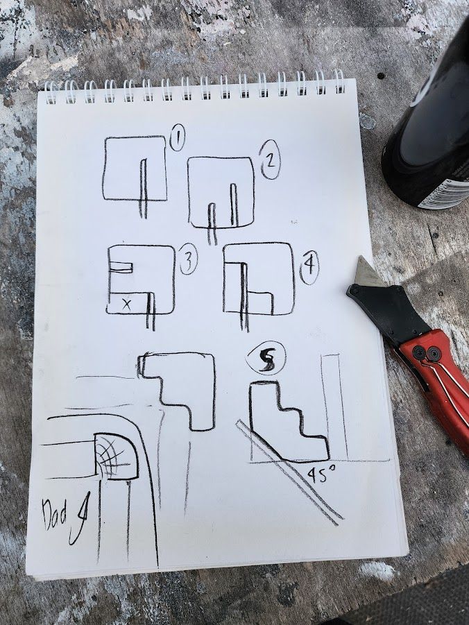

For me I would go with a table-saw if you have access to one - or maybe a men's shed?
5 cuts.
Difficulty factor? 3 outta 10, I reckon @Dave-1 . 😁

With well over 30yrs of power tool training, I personally would rate this rip cut as a "do not attempt" in difficulty with a high danger factor with a circular saw, rip fence or not. There is no possible way you can safely secure the material and control the depth of cut in a dead straight line with essentially under-sized timber. And unless you have a router table, this is far from a free-hand cut either.
