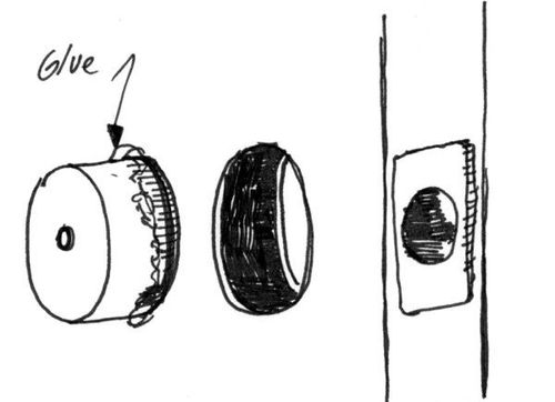

I had six doors where the flanges of the new latches were slightly smaller than the existing hole.
With a hole saw I cut "wheels" from 35mm thick wood - slightly smaller than the existing hole diameter.
Lathered Selleys Rapid Cure glue and insert. Cures in 10 minutes. Apply Builder's Bog in any depressions - and eventually sand.
Worked a treat.
