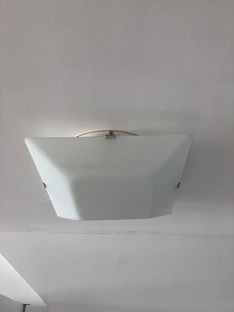

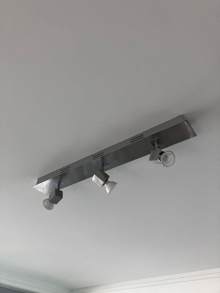

We are planning to replace a few light fixtures in the house with the help of an electrician, however some need to be moved to a different spot and others changed from a track light/oyster light to pendants. Therefore, we anticipate that there will be holes left by the old light fixtures (photos attached). Would appreciate any advice on how this is normally fixed.
Thank you!

If the holes are only very small, they can be filled with Selleys 180g Spakfilla Rapid Gap Filler - 180g. Once the filler cures you can sand it down level then wipe clean before painting the surface.
Here is a handy step-by-step guide: How to patch a plaster wall (some of the steps are applicable to your project)

Up to what size hole would you recommend using the gap filler, and what would you use for a hole larger than that?
Hello @chumchurrum
If the hole is bigger than a one-dollar coin, it will be necessary to use Selleys Spakfilla Wall Repair Kit. This set comes with a patch that helps with covering larger holes in your wall or ceiling.
Hi @chumchurrum
There may be multiple holes to fill and that is not necessarily a problem. There will be a slightly larger hole where bthe wires used to come throuugh and possibly more where the fixings were installed. the biggest problem you face is if they used fixings that have a face plate on the surface such as...
https://www.bunnings.com.au/ramset-m5-x-9mm-hollow-wall-anchor-10-pack_p2260116
or
https://www.bunnings.com.au/ramset-13-x-42mm-zinc-wallmate-anchor-100-pack_p2268280
The problem with these is they have a surface finish and so stand clear of the finished roof plaster. The only way to deal with them is to remove them or sink them into the surface before filling over them
Once you have dealt with this, you can fill ( it may take multiple applications for the cable access holes) then feather paint the repair (feather paint refers to blending out the paint to match in without needing to repaint the whole roof)
