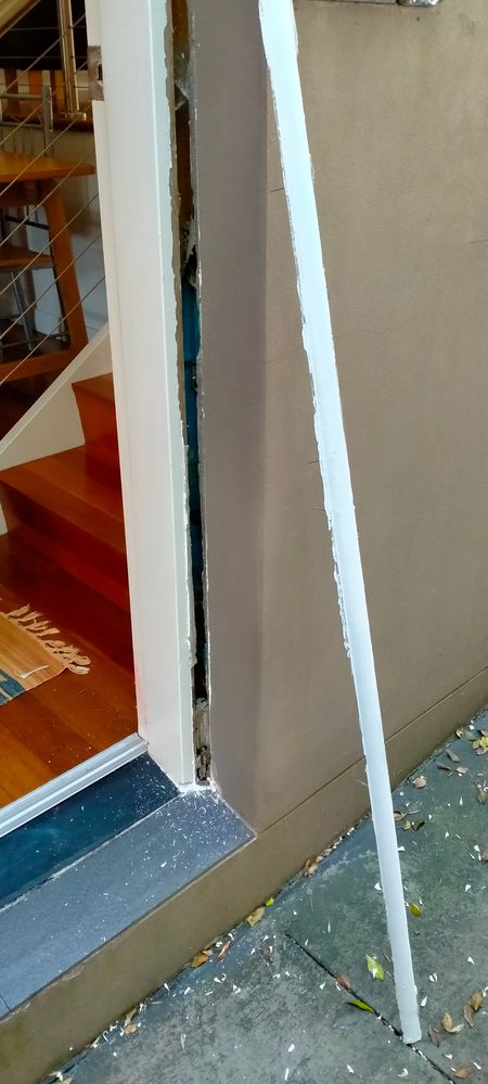

Pulled off outside front door trim that was the cause of water coming in to the door frame and the cause for the door sticking.

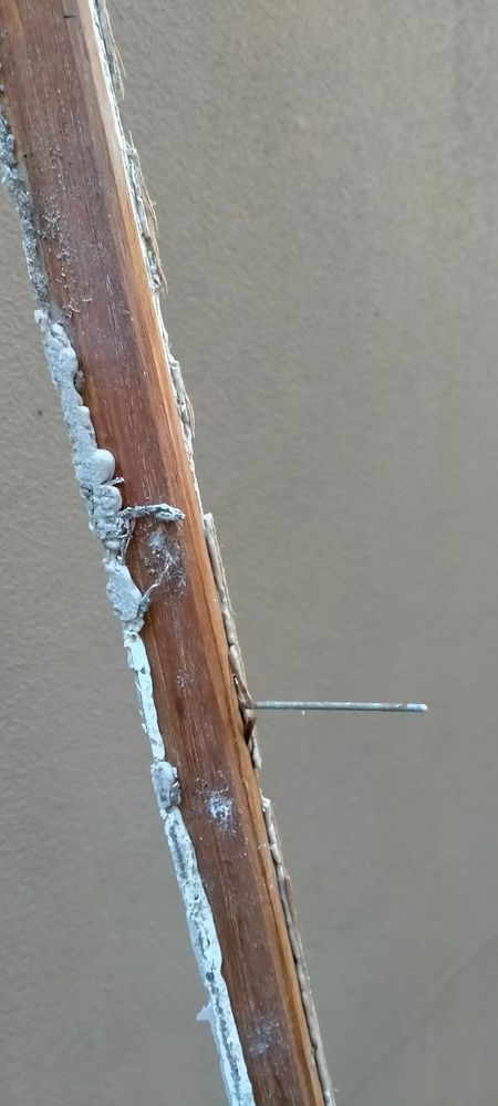

I wanted to remove it as some one had seal it with silastic while attached to the door frame and the sealing and edges from painting look very messy with no straight lines.
Strip removed
Messy sealing job

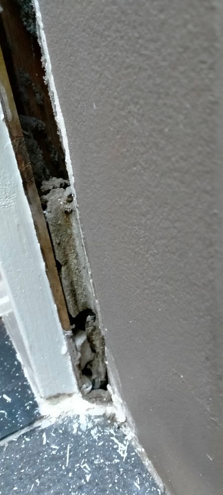

But there is a huge hole.
I was going to seal the gap and paint the strip and wall separately and then refit the strip but I wounder if there is something I can do to seal this hole and then fit the strip.
The damage from the leaking strip
This is where the water was getting in from the outside door strip into the frame and causing the frame to swell and then jam.
Hi @Kvic
It looks like someone tried to repair it with a great deal of silicone. To cover the gap between your door frame and the wall, I suggest adding an extra piece of timber moulding like Porta 40 x 12mm 2.4m DAR Tasmanian Oak Select.
But before you attach that moulding, I recommend sanding off the old paint on both sides of that gap. I suggest using Crommelin 1L Flat Aquablock Waterproof Primer Undercoat on both sides and the timber moulding.
Once the timber mould is secured in place add another coat of primer to seal it in place. I advise getting a new door trim and painting it with the same primer before you install it over the timber moulding.
To add an extra layer of protection, I suggest applying Selleys 430g White No More Gaps Exterior Gap Filler on all the timber joints before painting it over with the topcoat.
