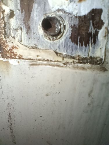

Hi folks,
I am having some trouble removing a door latch. What the problem is, is that the one screw that is installed had to be drilled through but the head snapped off when extracting it so I am now left with (see image) and on-top of that the other fitting securing the latch seems to be an Allen key fitting but I might be wrong. Any advice to remove these would be greatly appreciated.

Hi @TJP,
Is this the striker plate on the door jamb?
Looking at its condition, I imagine you won't be looking to reuse it. Is that correct?
You could remove the paint from the top fixing using some paint stripper to reveal exactly what you are working with. It looks like it could be one of three things; a hex head screw that would require an allen key to remove, a damaged phillips head screw or a rivet. If it was a damaged phillips head screw or rivet, then it would need to be drilled out anyway.
Considering the bottom screw has already been drilled out, doing this again is likely your best option. Without the heads on the screws, there is nothing actually holding the striker plate in place, so you should be able to remove it using a pair of pliers, or by levering it off with a flat tool like a screwdriver or chisel.
Once the striker plate has been removed, if you needed to use these same screw holes, then you could just continue to drill out the rest of the screw that remains, or you could try using a screw extractor to remove them.

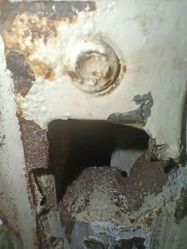

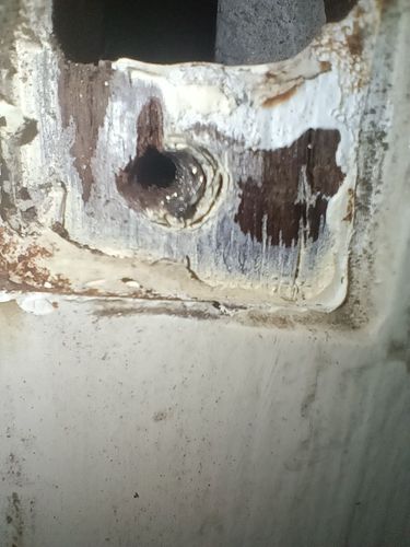

Hi @JacobZ
I managed to drill the top bit out of the door strike, but am having difficulties with the bottom screw as the only part remaining is the right half of the screw. Would this be a screw extractor job?

Hi @TJP
Ok so a larger drill bit to take out the head but then you will need to get a grip on what is left of the screw and extract it. If you can't do that, then you will have to drill it out completely which may not be easy and then fill the hole, preferably with a dowel and glue.
Hi @TJP,
Unfortunately, there's probably not enough there to use a screw extractor anymore.
As @R4addZ has already mentioned, you might have to use a larger drill bit to get the head out.
Or you could try putting a flat head screwdriver on the outside of the screw head and striking it with a hammer to bend the head towards the centre of the hole. There's a good chance it will snap in the process, but this isn't a huge issue.
Depending on how much of the screw shaft is left, and the location of the new striker plate, you might be able to just leave what is left in the hole where it is and install your dowel in the existing hole.
If the striker plate puts the screw hole firmly over the location of what's left of the screw, you'll have to drill it out with a larger drill bit.
Let me know how you go and if you have further questions, please don't hesitate to ask.
