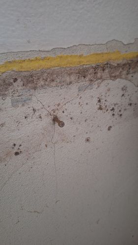

Hi guys,
I've tried usual claw hammer, vice grips, multi grips. Is there any trick to trying to get these 3.8mm diameter nails out of brick wall with render? They are solid!!! My last resort is cutting them off.

Thanks, had tried with a smaller pry bar but will go pick a longer one up tomorrow and give it a shot!

Thanks for all your suggestions guys, no luck unfortunately (tried the wrecking bar with timber etc). Will be getting the angle grinder out.
