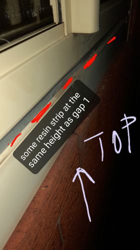

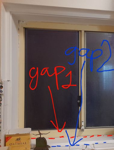

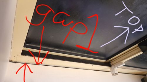

In this colder than usual winter I started to seal doors. And now windows. Turns out for all windows in this apartment and also all windows in the common area staircase there is a gap between window and window sill. It doesn't leak, just I am concerned about drafts and heat loss. Is it because such window is old?
Outdoor view, there is some resin flap , it is flexible at the bottom and attached along its top long side probably allows water to go out but not in:
The question is, is this gap by design or is it safe to seal it with silicone?

The good thing about silicone gap fillers is that they can be removed. As a rule of thumb if the gap is not interfering with the operation of the sliding window you can seal it with a gap filler. If you're worried about condensation getting trapped, you'll have to keep a bit of the window open when that happens. If you happen to start getting a puddle observe carefully where it occurs and see if gathers into a particular part of the window. I recommend removing a bit of the silicone if the water needs an exit point.
I suggest using Selleys 475g No More Gaps Interior Multipurpose Gap Filler it works on a variety of surfaces and has superior flexibility.
