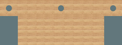

I've messed around with a couple considerations (2nd pic), including some desk drawers underneath each side at the front, with 3x desk legs situated at the back but unsure if this would provide the required support.
Hoping to get some advice on what type of supports/legs to use, best placement for them and anything that can help to prevent any type of sag through the middle of the desk top. If there is a solution that doesn't involve a desk leg situated in the exact centre of the desk, that would also be much appreciated.

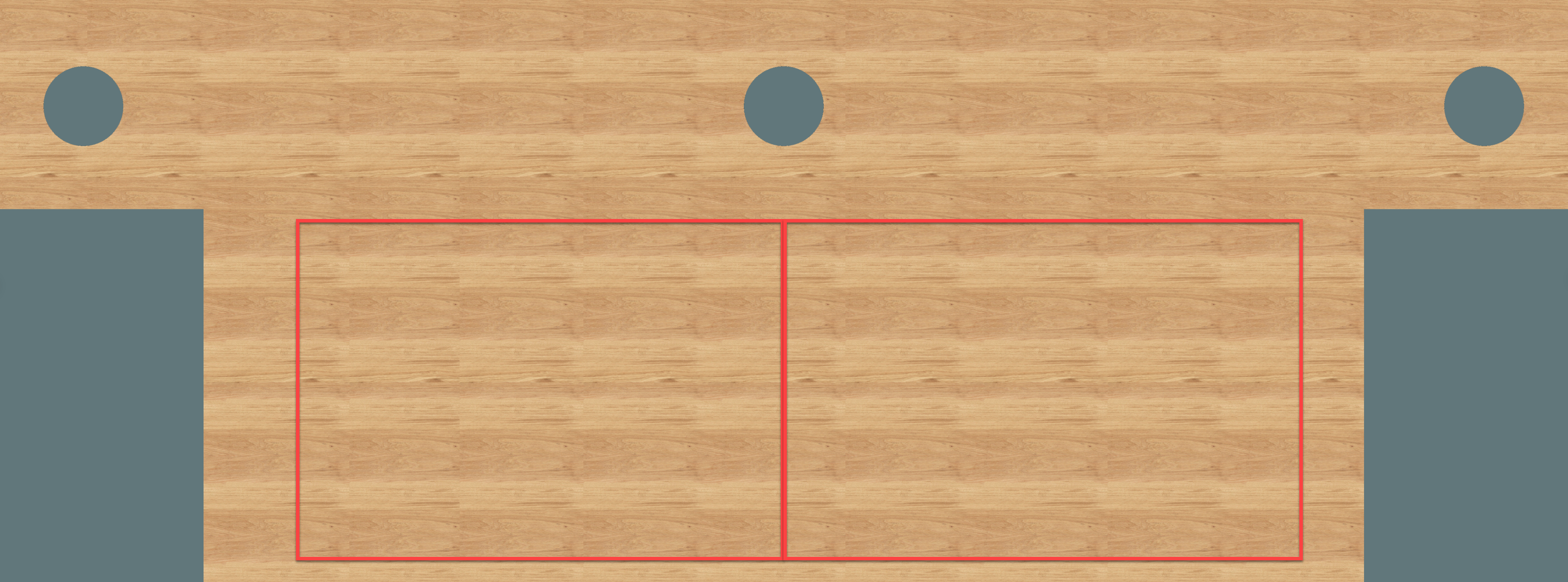

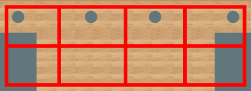

Would something similar to this be worth it, instead of having those angled cuts and then getting a 4th leg or is that too overkill do you think?
I don't mind the idea of the frame underneath and then plywood over the top to 'smooth' it out. Out of curiosity would there be any metal kind of flatter brackets that could work and provide the same strength or is wood the way to go here?
Ah I should clarify, I meant that the squares are placed vertically as though they are legs. That way, you can leave the area for the human legs clear of supports for the desk legs. However, in a similar fashion, what you've pictured will add strength but figuring out quite how much is sufficient is another question. One thing to bear in mind is that having supports attached to the underside can really suck if you have tall legs or like to cross your legs on your chair etc. I preferred to keep the area in front of the human completely clear.
Ahh yep that makes sense. Yeah leaving the centre open is a key for me as well, I may be able to get away with a central leg positioned at the back of the desk though with the desk being 900mm deep. My current one is 800mm deep and I only reach the wall if I stretch my legs out all the way.
Might be something I kind of have to reconsider the sizing of the desk itself. It absolutely needs to be 800mm+ deep but I may be able to get away with having a shorter desk top to make it easier to support.
Thanks again for your help.
The key is that whereever you put the legs, if you add horizontal bracing between them that the desktop rests on, you're adding better support and distributing the load better. I quite liked making the frame of vertical squares, particularly having some that are perpendicular to others, as it helped add a horizontal rigidity to the design (i.e. no matter the weight on top it was safe from being pushed from the sides).

At 38mm thick, your desktop is already going to be pretty solid, but additional reinforcing will likely be worthwhile. I think using 4 legs at the back with your 2 drawer units at the front would be good. Something like these Taskmaster 700 x 50mm Black Steel Table Legs mounted to the underside of the tabletop would be a good option.
I would install the legs and the drawers, then assess how the desk feels. You can always add some bracing to the underside of the desk after testing if you feel that it is needed. The bracing could be made from timber or steel, depending on what you prefer. 70x35 pine or some Australian Handyman Supplies 50 x 25 x 2.0mm x 2.0m Painted Rectangle Hollow Section Steel would work.
As the main area that needs support is between the drawers, something as simple as this should be enough.
