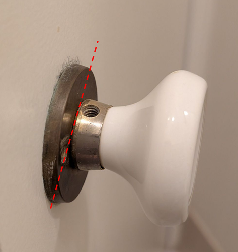

Start by giving a good tap around the job with a hammer on both sideband see if it can't be loosened. Failing that I would cut the connecting shaft between the jobs with a hacksaw like this type. It will take some time to get through the approx. 10mm square shaft. Once through the other side knob should pullout. The outer dark gold ring is probably stuck from paint, so they can be pried off.

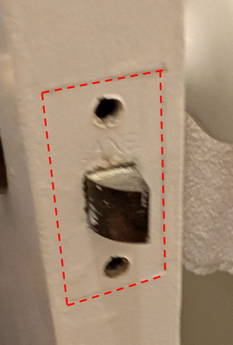

Use a sharp blade to cut along the latch plate as it's been painted into place. Then push a screwdriver through the square opening of the latch where the connecting rod was holding the knobs. Holding the screwdriver on both ends. pull the latch out.
