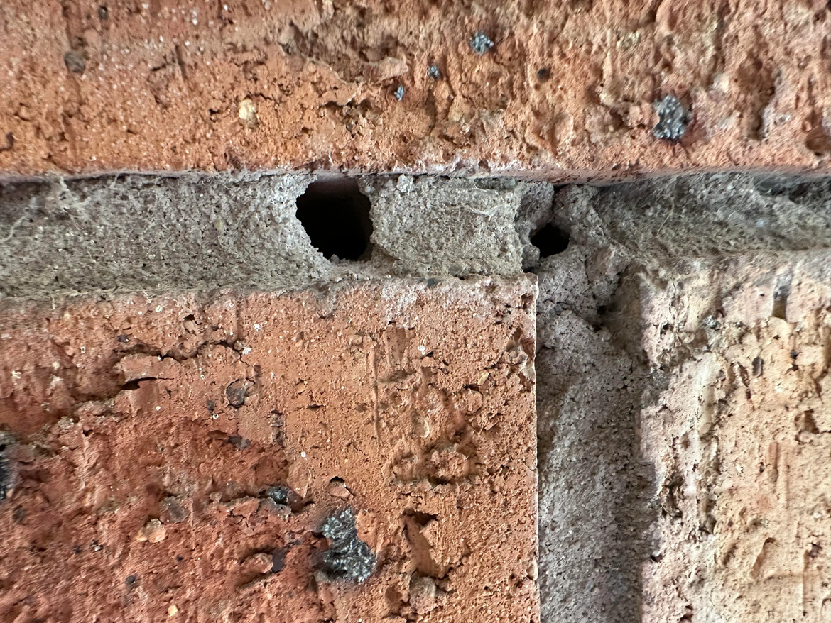

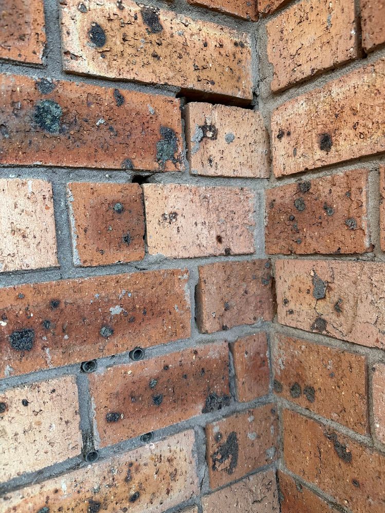

Hi this is a house in Sydney built in early 90s. I'm wondering what's the material of the brick pointing, and is it easy to top it up myself? Thanks.

The material used between the bricks is mortar, which is a mix of cement, sand, and sometimes lime. If you have small gaps or areas where the mortar has worn away, you can top it up yourself using fresh mortar.
The easiest way to do this is with a tuck pointer or pointing tool. Simply prepare a small batch of mortar to a stiff but workable consistency, then use the tool to push it firmly into the gaps between the bricks. Make sure to pack it in tightly so it bonds with the existing mortar. Once filled, smooth the surface to match the surrounding pointing, and allow it to cure according to the mortar’s instructions. With some patience, this can be a straightforward DIY task and will help keep your brickwork looking tidy and structurally sound.
