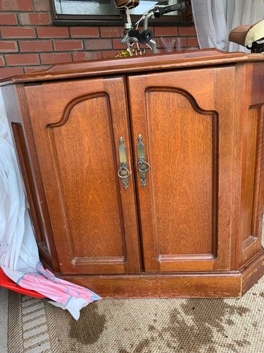

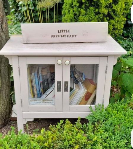

I am wanting to make this cabinet into a street library.
I will sand back and repaint.
Looking to remove the inner panels on front cabinet doors and was hoping to replace with a semi thick clear plastic (not sure of the name) or even if it can be done.
Any recommendations much appreciated
Photo 1 - is the cabinet I want to make over
Photo 2  - to show the style of door I am wanting to do

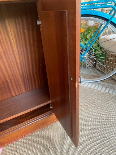

Is it possible to get some photos showing the inside of the doors?

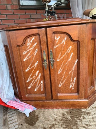

I want to try and establish whether the pieces I have placed arrows on are the main structure of the door, and the inlayed piece is a backing sheet that could be removed, or if we would need to cut out the inlay with a router.
If it is a backing sheet, you may be able to just pry it off with a claw hammer, pry bar or chisel. Once removed, you could attach a piece of clear acrylic to the back of the door frame using some short button head screws, ensuring you predrill the acrylic to prevent cracking.
If it is not a backing sheet and it can't be pried off, a router with an inverted trimming router bit is going to be the best way to remove it. You would start by drilling a hole in the inlay that is big enough to stick the router bit through. Then, you would insert the router bit, running the guide wheel (see below) along the edge of the timber to follow the line of the timber. Once cut out, you can then attach the same clear acrylic to the back of the door using the same method.

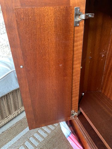

It appears to be just a panel that can be removed.
In regards to your recommendation of acrylic - how would you cut this down to size as door panel is 20cm wide and 90cm long
Would perplex work as well? And if yes does Bunnings sell this?
Re: Cabinet Door - Inserts
Hello @Misha70
I recommend having a look at the Palclear 900x600x3mm PVC Sheet Suntuf 171868. The clear panel can be cut down using a small handsaw. The clear sheet can be screwed onto the timber frame by carefully drilling mounting holes in the sheet. My best advice is to drill slowly and carefully to prevent splitting the panel. Another method is to use timber strips to hold the clear sheet in place.
