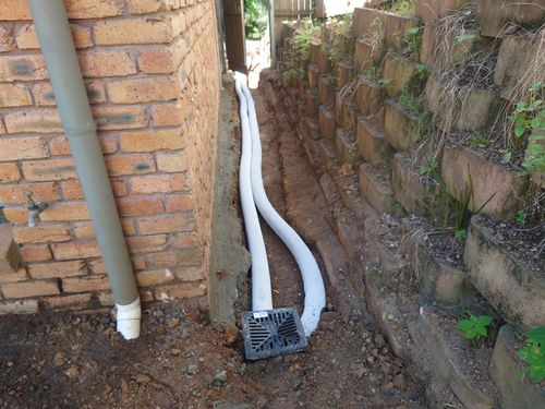

On a side note, what was the waterproofing product they used? I can see the cement ledge they've created along the wall, but did they actually paint the wall with a waterproofing membrane?

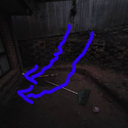

The plumber we hired only built an agdrain channel from the corner of our house. Shorter than we what we agreed upon. It should be longer aligning with the retaining wall We have learnt a lesson about how we should make it clear on the quote.
And because of the water table, under ground water is still flowing from the neighbors higher ground to our bedroom.
Its a bit of frustration. But we wont give in.

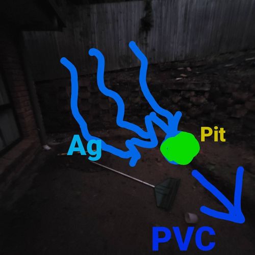

So now, we are planning to make an agdrain channel to keep the rainwater from coming in:
Agdrain ->attached to a drainage pit -> then through a pvc pipe

So much information here and have not had time to read it thoroughly but get the general idea of your ongoing issues. Below is some general information that you may or may not already be aware of. A decent waterproofing professional should be able to unpack your specific problem and offer a solution.
1. With any water ingress it is always best practice to deal with it from the positive side. In your circumstance that is outside.
2. Aim to drain as much water away from the area as possible.
- I can see you have already attempted this and the drainage looks to be in a good position - away from and slightly below the strip footing.
- Personally, I would never use flexible Agi pipe as it is prone to silt build-up and clogging which is very difficult to clear in later years. I would always use solid pvc pipe with slots cut underneath and an inspection/cleaning upright (at 45ish degrees) finishing above ground level so you can clean that pipe out later without excavating.
- Above that drainage pipe should be free-flowing aggregate - scoria or similar - and ideally a crushed rock/pebble/concrete overlay.
3. If you have earth or aggregate up against an exterior wall that is higher than your interior finished floor level you MUST have a waterpoof barrier in the form of a liquid or sheet membrane system to stop lateral damp.
4. If you have earth up against an exterior wall that is lower than your interior finished floor level then you need a damp course either installed in the brickwork or retrofitted in the lowest possible course above the earth level outside.
5. Even having done all of this you can have residual moisture in your walls that can take many months to disappear. This is what you may now be experiencing.
6. If you have moisture (but not running water) entering through masonry or concrete on the interior then you can stop this by applying a two-part epoxy vapour barrier. Products I use are Gripset E60, Ardex WPM 300 and Fosroc Nitoproof 310 which are all excellent products but must be applied carefully and with some knowledge/experience.
7. If you have more than moisture (rising water) entering via a concrete slab then really the only option is to inject either hydrophilic or hydrophobic (dependent on the exact situation) to fill any voids within and/or under the slab. Again, a decent waterproofing professional should be able to advise.
8. Not wanting to rain on your technology but the moisture meter you have is completely useless for what you are trying to achieve. It will not give you an accurate indication of moisture in concrete and only a very very rough idea of moisture in timber. In my job, I use a couple of moisture meters, the two of them are close to $3000, and still struggle with certain situations. For example, my Tramex X5 is specifically designed for concrete but can only measure to around 7% moisture so anything above this is basically measured at 100%. What you are using will only mislead you.
