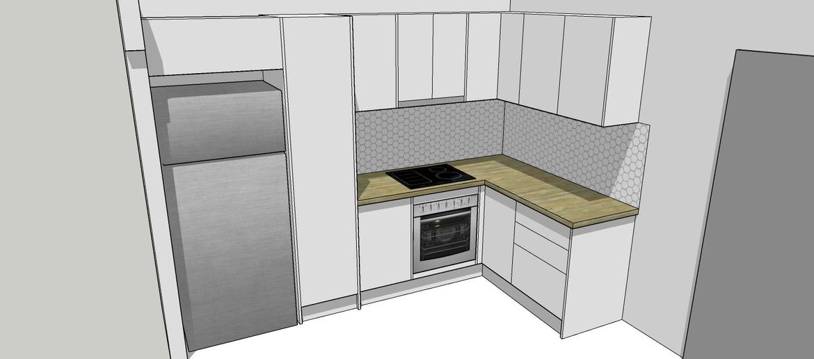

@redracer01 This is amazing, thank you so much! I hadn’t thought too much about extending that side of things because the current oven setup is all double brick and will be expensive to remove. I think it’ll be worth it in the end though.

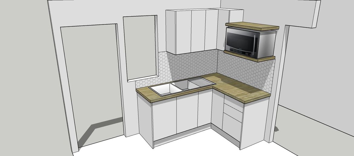

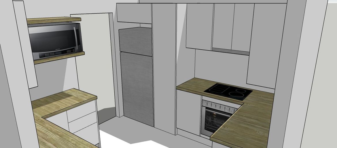

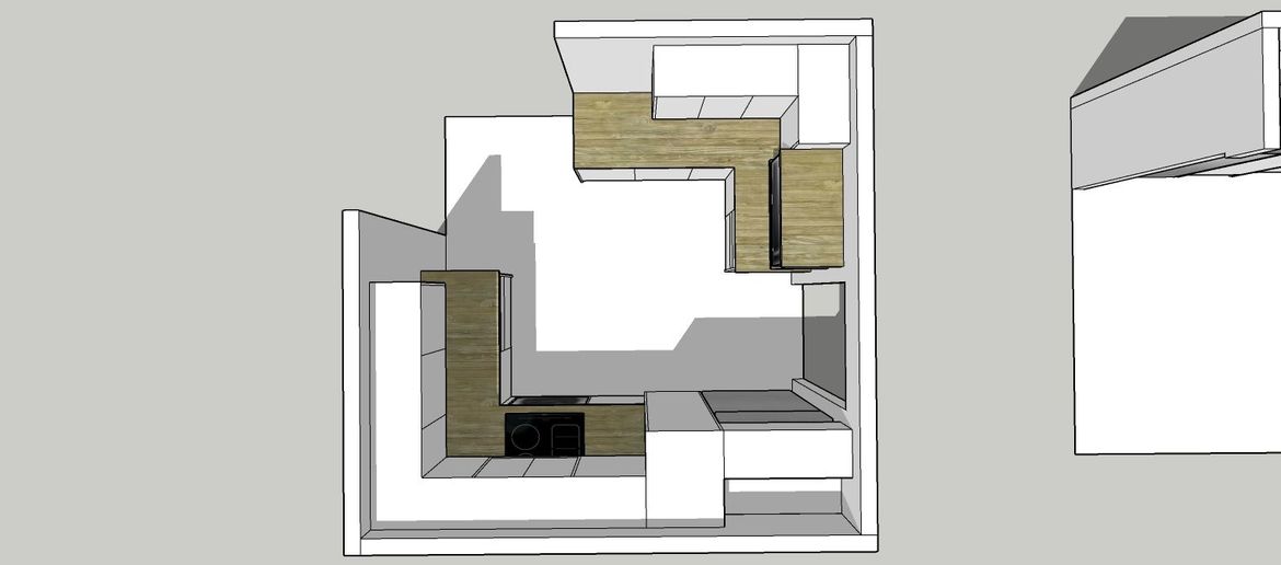

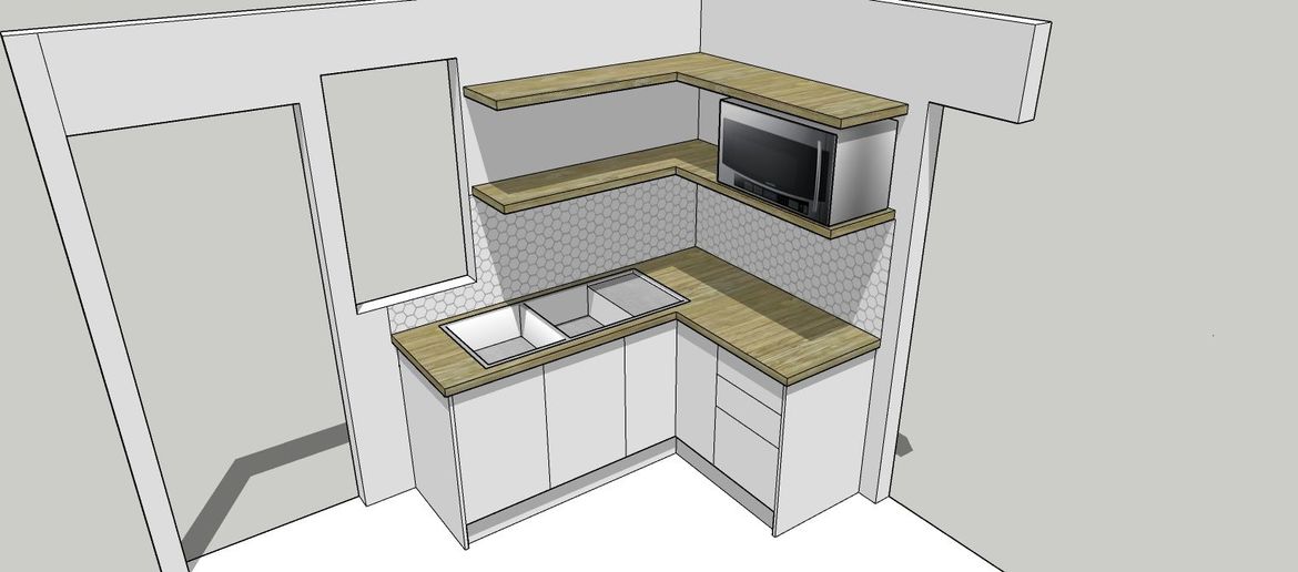

Here are better views. This of course is on the assumption that the current dividers and shelves on the cooking side wall can be removed and we can have a plain straight wall to start with. This kitchen is based on measurements at 3 meters x 3 meters. Looking at your plan it seems to be more or less the same size as one of your bedrooms. If you have any questions please send me a message here on workshop. Enjoy the pictures.
I've left the walls at the end unfinished for viewing purposes.
I'm assuming the door opens in. Represnted by the grey door on the right.
Sink side with cabinets.
Sink side with shelves.
The view commin in from the outside door.

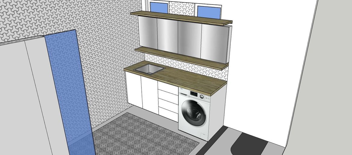

This is a very special cabinet mirror. It's a custom cabinet mirror with some special features. It's 1900 mm wide 600mm tall and about 150 mm deep doors included. The last cabinet door on the right and the last door on the left do not have any backing board. This allows you to put your hand through and still open the windows. It is suppose to occupy that entire wall from left to right. The cabinet doors can be left open to allow sunlight to come in during the day, seeing as the sun seems to be shinning through in the afternoon. How ever at night the doors can be closed and it will have that seamless look. Because the cabinet is mounted on the outside wall and not on the interior center wall of the window there is a lot of space for ventilation. I suggest LED lights under the bottom shelf and above the top shelf. Your exhaust fan should not be a problem as you can install it in the same place and will still manage to have enough room to function without any hindrance from the mirror cabinet. The question is how much will this custom wall cabinet cost you. If you think the idea has merit drop me a line and I will post the proposed cabinet with measurements.

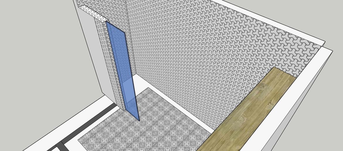

I suggest we remove the bath unless you like to soak. A standard 400 mm glass shower panel from highgrove should finish it off and tiles of your choice. Soon as chance permits I will post a few more ideas.
I suggest wall hanging the cabinets to protect them from any possible water mishaps.
What it might look like withot the bath.
