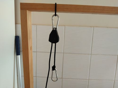

And finally the lighting system is in place..
Those little black devices are miniature hoists.!!IMG_20221111_140030[1].jpgIMG_20221111_135600[1].jpg
Re: I'm Growing Hydroponic Tomatoes
Hi @Prof
Thank you very much for that update. That looks to be an excellent method of adjusting the light. Once the plants begin to get taller you can simply pull on the rope and the lights will go higher.
We look forward to the next update.

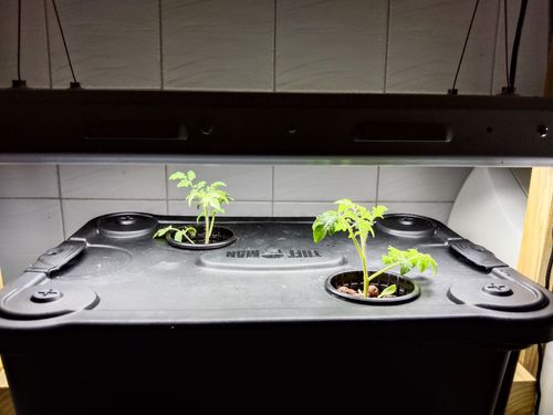

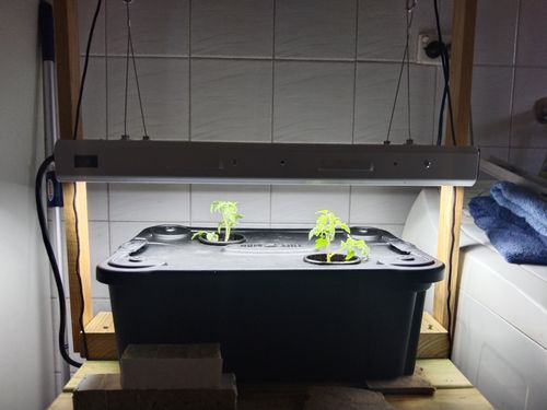

IMG_20221112_132047[1].jpgWe have hydroponic tomatoes under way.!!
Prof
Amassing an Audience
At the moment the plants are just sitting in water..
The instructions on the fertilizer packet suggest leaving them in plain water for 1 week..Then for the next 2 or 3 weeks they will sit in  a water solution with 50% addition of fertilizer..
Then at the beginning of the fourth week a full strength water / fertilizer mix can be put into the tank..

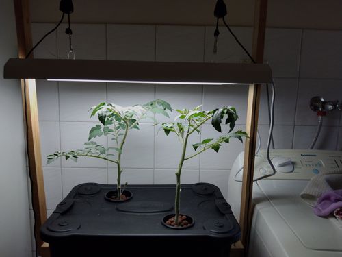

Well it's the beginning of week 3 when I'll be making up the fertilizer mix to full strength..
In last week there has been significant increase in the size of the plants.! so much so in fact that I had to raise the grow light to the maximum height possible..
Also there is now a long thick root system protruding from the net cups..All in all I'm very happy with how quickly these plants have grown.!!
I can't imagine what's going to happen when I give them the full strength fertilizer mix.!!

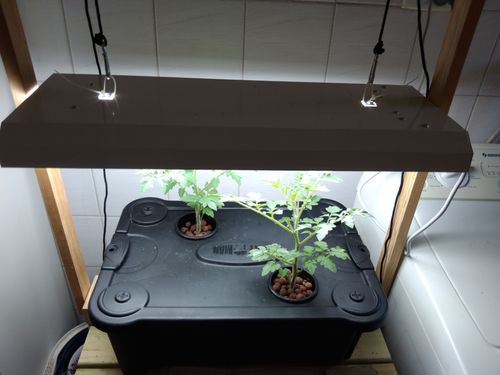

I realised that I would need more height adjustment for the grow light so to that end I bought a new fluro light..
This light has two double tubes (4 in total) and puts out about 70% more lumens..
On the back of the unit it has a small stand up at each end..This gives me much more adjustment on the hoist system than previous..
Here is a photo of the growth currently..If you compare these to the original photos you can clearly see the increase in growth..

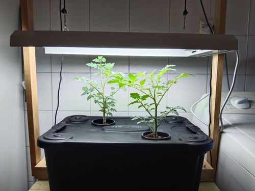

I've now set up my hydroponic garden.!! I've added two 20L.buckets..one for each plant..This will help the individual plants to expand with no limitations..
I also set up the twine supports for the plants to cling to as they climb..
The growing rack is also now assembled and I will be using that for growing other vegetables..
Here is a photo of the plants in the original tanks that shows how high up the growing lights are now.!!
I've also trimmed the plants to remove unnecessary stems and leaves which will help to keep them away from the bottom of the plants..
This will help with air circulation as they grow bigger..
