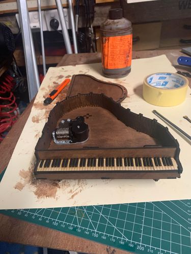

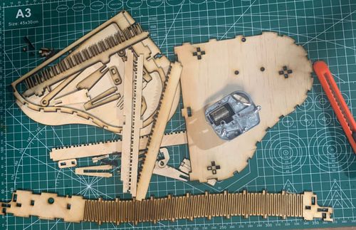

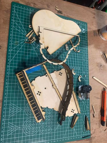

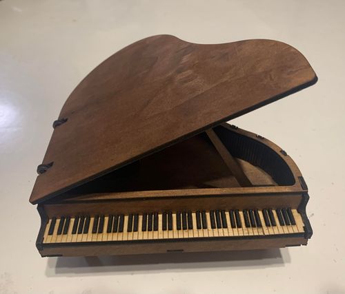

I used my laser cuter to make a music box Baby Grand Piano. I used 3 ply from Bunnings, which work great and got the movement online.

Re: Laser cut music box
A little more info about this build. I used a C02 laser cuter, known as a K40. Its has a 40w tube and is water cooled with air assist from an air pump to help with the cutting and an extractor fan for the smoke. Its only a small laser cuter in bed size and does about an A4 size board, and this just fitted on it. The stain was just a water based stain I had and used for leather work and then just a clear coat. The black keys are just black spray paint and the white keys are just the natural wood colour, but the lines on the white keys is laser cut lines. All just glued together with PVA glue. The music mechanism from EBay for about $5.00... I have seen 3D printed music mechanism, maybe next one.  I did have to modify the lid a bit to turn of the music when the lid closed, and start playing when opened. I did this with a little copper post attached to the lid that stoped the music mechanism from turning.

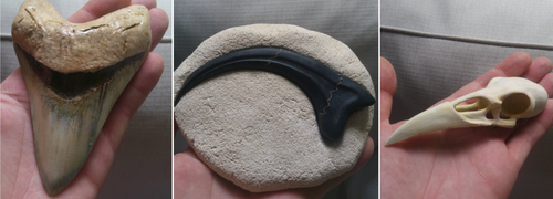

I enjoy crafty-type projects, so I have been enjoying printing objects and painting them @Super_D. I've added an image below of a megalodon tooth, Grant's raptor claw from the movie Jurrasic Park and a raven skull that I'm currently painting. Also, a lot of functional prints like missing/broken pieces. I've done a few items like paper roll holders that I could have likely bought for cheaper than the filament cost.

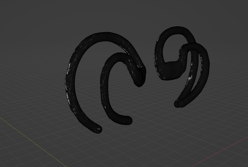

I have also taught myself to use Blender over the last month to start creating organic shapes. I did this as I wanted to design a 3D-printed ear appliance to assist doctors in correcting ear deformities in babies. Apart from plastic surgery, there is a small period where the cartilage in a baby's ear is soft enough to re-shape it before it hardens and takes permanent shape. Many ear deformities can be effectively treated during this period. There's one plastic surgeon in Australia that performs this treatment for free, and I was lucky enough to be able to take my son to him for his Stahl's ear. It is a condition that resembles pixie ears. It's nothing particularly worrying, but it's nice to try and take some of the pointiness out of them. This doctor sees hundreds of patients each year and keeps costs to a minimum. We didn't pay a cent. He and his daughter, that is also a plastic surgeon, spend their evenings bending lengths of wire and forming them into little braces that go in the helix of the ear. The brace is taped in position. We had a lot of difficulty with the tape coming undone during this 3-month process and the brace shifting. I designed these appliances to slip over the ear and provide a better support structure. My hope is that they could also be used to help with more severe deformities. Given the 3D printing filament I've used softens from heat, you can dip the appliance in hot water for five seconds, and it becomes malleable yet is only warm to the touch. You can then place it over the ear and manipulate it to the shape needed. You'll see in the video below the 3D-printed ear buck that I used throughout the design process.
Now that I have the design down and they are printing well, they only cost around five cents each to make. I plan on sending a few dozen to the plastic surgeon to get his feedback. I've only just discovered that a similar 3D printing device was being trialled in New Zealand, and it's had great feedback. Apart from this manipulation of soft cartilage, the only real other option is plastic surgery, which in the case of Stahl's ear, is likely not covered under insurance as it's considered a cosmetic issue and doesn't affect hearing.
