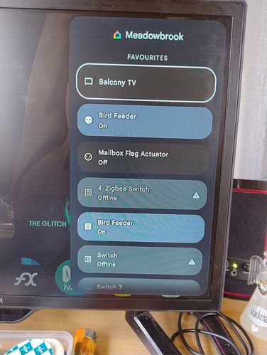

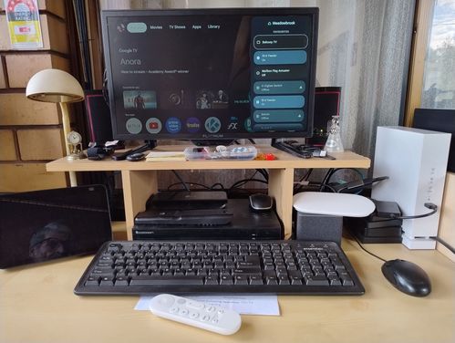

Here I am last year excited about setting the Google TVS before moving to the lounge room.
That setup is on the computer desk return... my sandpit.
Waiting for Google Home to sniff out all the devices and appear on the shortcut menu.
Device list not as yet setup.

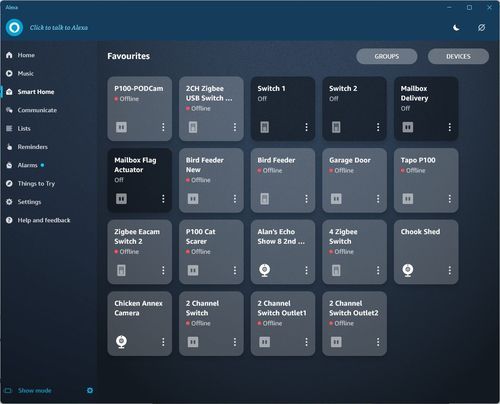

Looks like this... Alexa on Win11 Pro  desktop.
