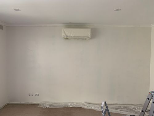

      I did apply 2 coats of https://www.bunnings.com.au/search/products?q=Zinsser%20B-I-N%20Primer%20Sealer%20Stain%20Killer&sor... on drywall and I see no bleed of old red colour.
Can I directly apply Dulux natural white paint on top of Zinsser BIN or need to undercoat with dulux 1step primer before coating natural white paint?
I also read somewhere that we need to dewax shellac paints before applying water based paints but didn’t get much information anywhere.
Appreciate if you can please give more information on dewaxing and if it is needed for me?

Re: Looking to paint skirting
@approachmhn,
You can go directly over the Zinsser product with Dulux water-based paint. There is no need for primer, and the B.I.N does not need to be de-waxed before applying a water-based or oil-based topcoat as, unlike traditional shellac-based primers, it does not contain any wax. Please allow one hour before coating with water-based paints and 24hours before oil-based.

Hi @MitchellMc,
      Thanks for the update.
Was bit confused with all the contradictory information on internet.
As suggested, I did 2 coats of Zinsser BIN Wednesday 6 Oct on red wall and now I don’t see any bleed through. Looks good.
will go ahead paint natural white on this.
regards,
Mohan
Mohan (@approachmhn),
I, too, read the misinformation on Google about the Zinsser B.I.N. I contacted Zinsser's technical assistance to double-check so that I would be giving you the correct information.
Looking great, keep us updated.

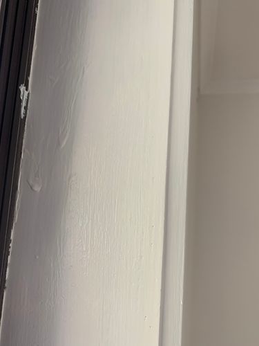

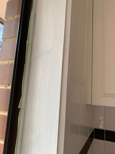

I did paint with dulux max adhesion primer on trims as suggested but it doesn’t block underlying old colour completely even after 2 coats.
also, I see paint drip marks 15-20 mins after painting dulux aquanamel on vertical window trims & paint brush marks.
Any suggestion on getting rid of both issues above will help?
