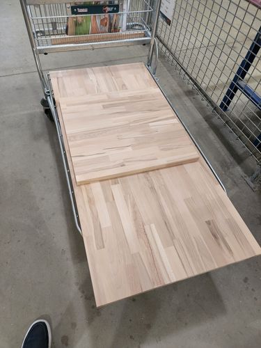

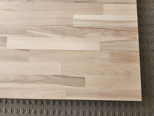

Renting in the city means I have no workshop space so my balcony was commandeered for this work. First step was the first (of many) 'trips to Bunnings' to get all the stuff. Beech wood panel was cut down to 1300 x 600 mm. Not sure what to do with the balance pieces - I'll think of something to use it for later.
Panel cut down to size at BunningsPanel cut down to size at Bunnings

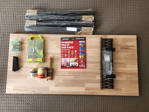

All the materials ready to go :smile:
All the materials ready to go :)All the materials ready to go :smile:

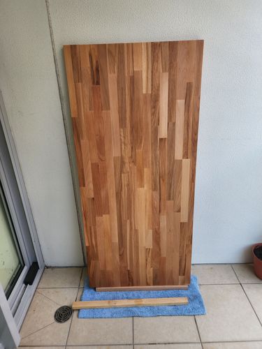

Did a test coat on the off cut pieces - Bondall 500ml Monocel Timber Bench Top Oil on the left, Cabot's 250ml Clear Water Based Cabothane Interior Varnish Matt . I definitely like the Bondall Oil waaaay more. Went with that.
Testing Bondall's Timber Benchtop Oil and Cabbots Cabothane ClearTesting Bondall's Timber Benchtop Oil and Cabbots Cabothane Clear

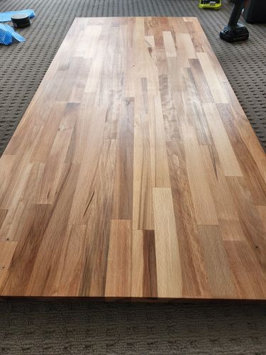

Next step was sanding down the panel to a smooth finish - started with 80 grit, then 120 grit, then 240 grit, then 400 grit for a fine smooth finish. Doing this manually without a sander was a real workout!

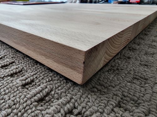

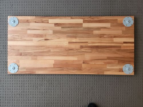

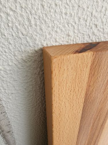

The edges were quite sharp, so I used the Trojan Surshape plane at a 45 degree angle on the edges to round them out just a little bit and sanded it down to a smooth finish. Once it was sanded to a silky smooth finish, vacuumed and cleaned it thoroughly and applied 3 coats of Bondall Oil, allowing it to dry for about 2 days between coats - it being so rainy in Sydney over the past few weeks, took longer to dry up.20220429_103257.jpg
Edges rounded off slightly.

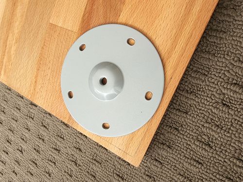

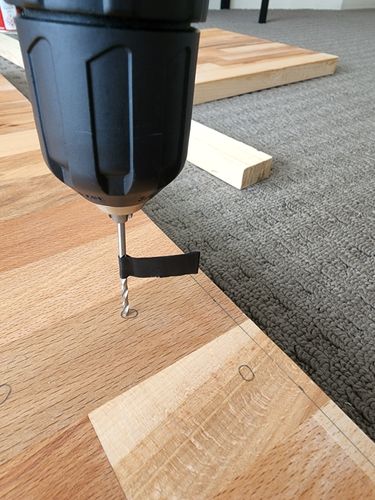

Leg mounting plates were offset from the edges by 6 mm.

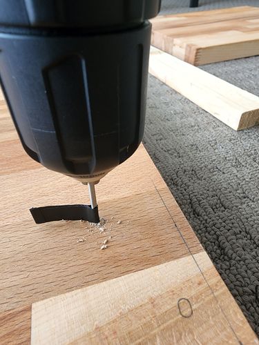

Attached a bit of tape to the drill bit to indicate a depth of 19mm to drill the pilot holes for the leg plates.
 Waxed both sides of the panel after it was completely dry and smooth to touch.

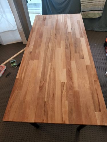

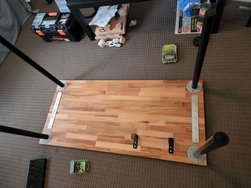

I noticed the panel was warping a little, by about 2 mm on one side, so attached a Carinya 340 x 40 x 3.5mm Zinc Plated Mending Plate - single at both ends, which straightened out the panel. Hopefully it holds!

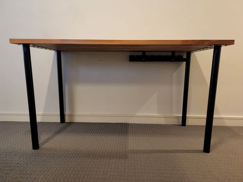

Also attached the Matrix Cable Organiser Tray Black on the underside. Flipped it over and gave it a final wax and left to dry for 2 days.

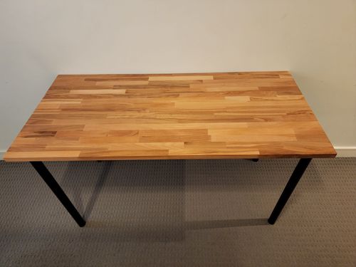

All finished and ready to use :smile:
