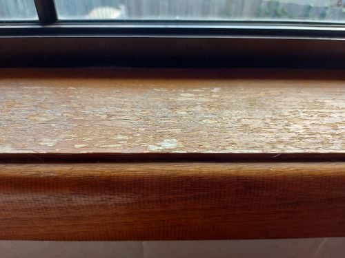

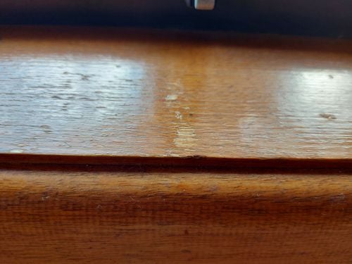

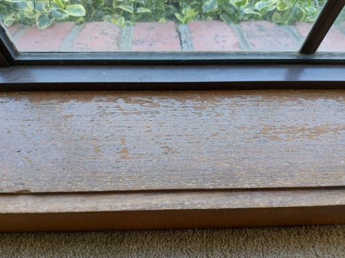

Considering doing some DIY with refreshing the window trims, as the lacquer is starting to peel off a lot of them, but unsure which is the right one to select. When I look up online, many sites I look at say to be sure I'm selecting it based on the timber type, but I'm not sure what type of timber it is. Additionally, when I try the Colour Visualiser on Cabot's website, the colour doesn't come up the same as what we have, so I'm at a bit of a loss what to do, or how to select the right product.
If it helps, the house was built in 1988, so unsure what would be the go-to timber at that time for windows.

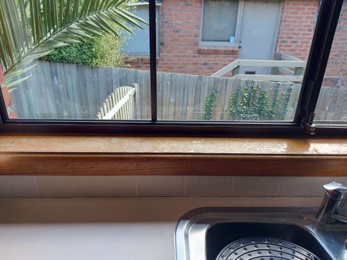

Can anyone help, or offer some advice? Should we just take off some of the existing lacquer and take it in? Additionally, how often should this be done (or how long does it usually last for)?This one is relatively fine, so it will show how it is meant to look

It's quite hard to colour-match a timber that has already received a varnish coating. I suspect it is likely a clearcoat with no stain present. Generally, the best approach would be to try a test section in an inconspicuous location to check the colour. Varnishes, even without a stain, give raw timber a honey-coloured hue. There is a good chance the timber is Meranti, but as you've found, it can come in a variety of different shades.
To get a fantastic finish, you'll need to sand those rough and discoloured areas with 240-grit sandpaper before coating. I'd suggest Cabot's Cabothane clear polyurethane varnish and a good quality brush for the application. Once re-coated, you should expect it to last between 10-15 years. Window sills that receive constant sunlight might require more frequent coatings. Varnishes can't be colour-matched as it is not a paint that contains pigments. However, you could take your pictures with you, and a helpful team member will provide some colour selection advice.
