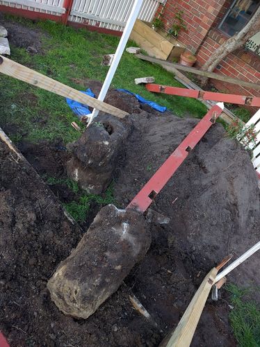

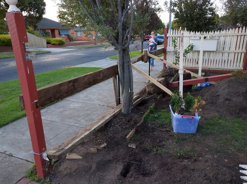

Well this is the end of day one of the fence work, got 1/2 the posts out and shoveled 2 cubic metres of soil out of the veggie garden to dismantle it and get to the fence properly, 3 posts to go, hopefully one a night after work. Thanks @Kermit -they were fully rotted out and snapped off, dug enough to get a rope around the cement footings then use a garden sleeper (+2 people) to lever it out of the ground with a lot of effort..had to loosen the soil a lot as the clay soil was effectively creating suction preventing the concrete coming up.
The before...
Post one...the easy one since the post was attached still, can see one of the concrete bases without a post as well to the left.
Temporary fence up, and holes covered over. It's stronger than the old fence was!

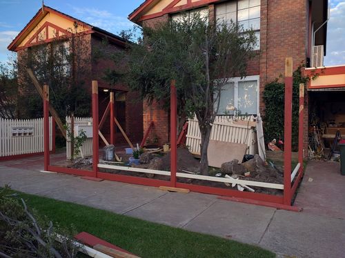

Well here are some updates. Old posts out, new posts are in. Had to hire a jackhammer to get a couple of them out, they were under the driveway, and didn't want to damage the drive trying to they them out.

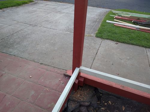

Started putting the rails in, cutting the notches was time consuming, getting faster with it though. Hoping to knock off a few rails each night this week, and pickets on the weekend.
Also an excuse to get some nice new grass - as you can see, the yard quickly became a war zone! So thats another job to add to the list...
