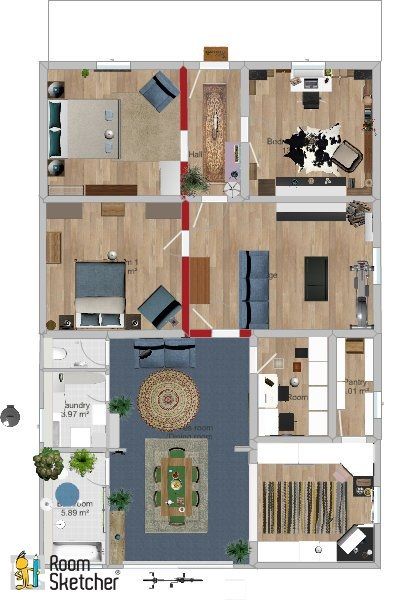

Yesterday we started renovating our "new" home on a shoestring budget
Watch this space for "before" and "after" shots (coming soon)
* planning, budgeting and juggling tasks
* "tradies wanted"
* opening up the wall between the kitchen and dining room
* choosing and installing a new hot water system
* living in a renovation
* choosing and installing the new kitchen
* plumbing and electrical
* repairing plasterwork and old render
* replacing the veranda
* installing the back deck
* enclosing the patio
* installing sliding doors to the deck
* sanding old hardwood floors
* remodelling bathroom, laundry and toilet
* upgrading pantry shelving
* repairing and hanging old doors
* repairing old brickwork
* prep and painting
* lighting
* concreting the driveway
* concrete slab for the garage
* choosing and installing a garage
* landscaping
* building a chook house
* going solar - towards off-grid
* gardening - towards self-sufficiency
* our mistakes (I'm sure there will be many)
... and the list goes on.
Watch this space ![]()
