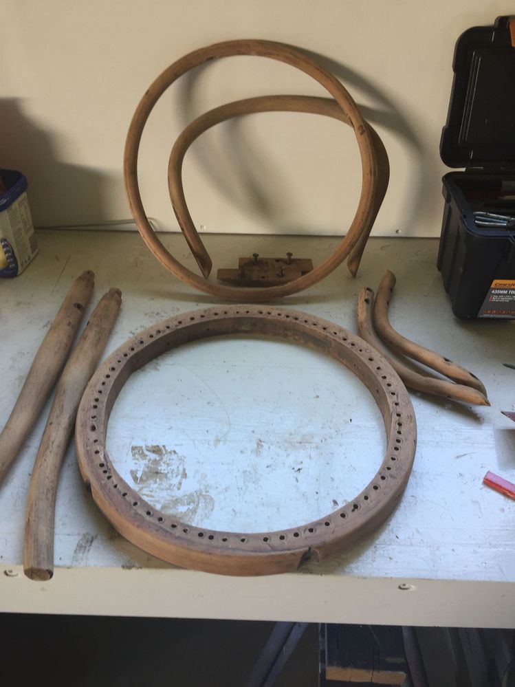

I have completely pulled one of them apart and removed the remnants of the old rattan cane from the seat. The underneath side of the seat which has a groove around the line of holes will be filled with a suitable two pack adhesive mixed with sawdust that closely matches the colour of the timber of the chair. The top side then needs a groove routed in that to take the new rattan seat that will be installed in a one piece sheet instead of woven. Had to use a fine blade in the angle grinder to remove the very rusted on nuts and bolts. Still deciding whether to use bolts or plug the holes and then use screws as they would have in the original chairs.

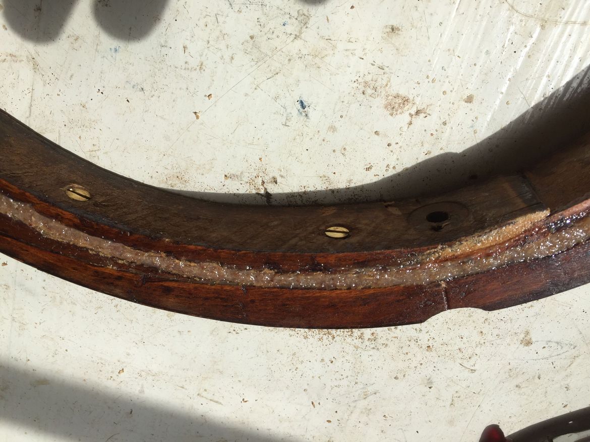

The chair ring has been filled around the underneath groove that was used previously for the rattan cane weaving. All parts now presanded and ready to fill the holes in the top of the seat ring before routing the groove for new rattan cane.Presanded partsPresanded partsBottom groove filled with two pack blended with sawdustBottom groove filled with two pack blended with sawdustHard to get slotted screws but found two brass ones for this piece.Hard to get slotted screws but found two brass ones for this piece.
