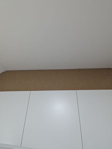

I have to put some new cornice on some.bulk heads we just got made
The bulk head is timber board

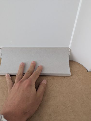

Now I a bit worried that the cabinet maker didn't do the bulk heads correctly to make it easy for the cornice to look ni w against the existing cornice
But I am hoping I am just not seeing the right angle to cut my new cornice
How would I cut my new cornice so it sits nice against the existing one?
Re: What gyprock plaster glue for cornice?
A Builders Edge Altamonte Mitre Template Plaster Tool is used to give you the correct angle @pat83. Because your existing cornice can't be cut with the required angle to meet perfectly, after you cut the new peice with the guide, you'll likely need to trim the back corner of the newly cut angle to get it to fit seamlessly.
