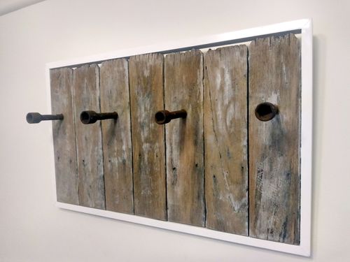

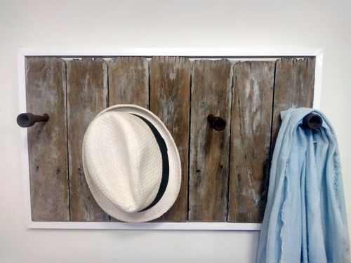

I've been working on a rustic coat rack inspired by some old hardwood palings I had lying around. I thought they would make a neat backing board. The palings have some nice texture on the top where they had weathered away over the years.
While searching for hooks, I came across an old rusty tire iron cross, so I cut the ends off it and glued them into the timber. I finished the rack off by adding a stark white timber border, which I think offsets the rustic look successfully.
I'm pretty chuffed with my efforts as it turned out better than what I was expecting. I look forward to seeing what everyone else is working on!

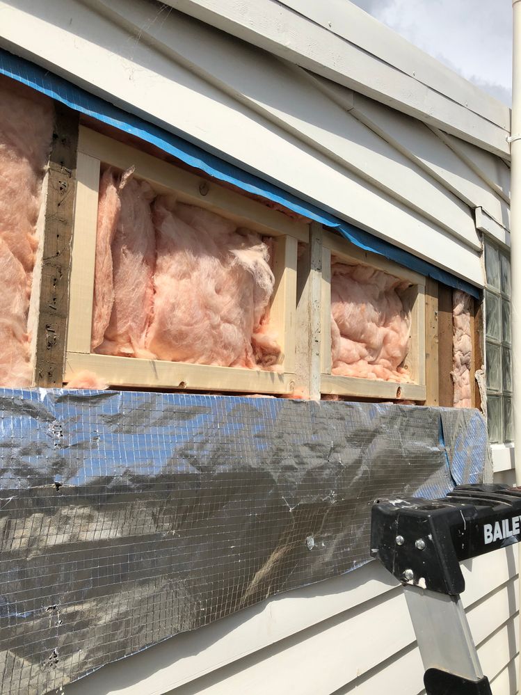

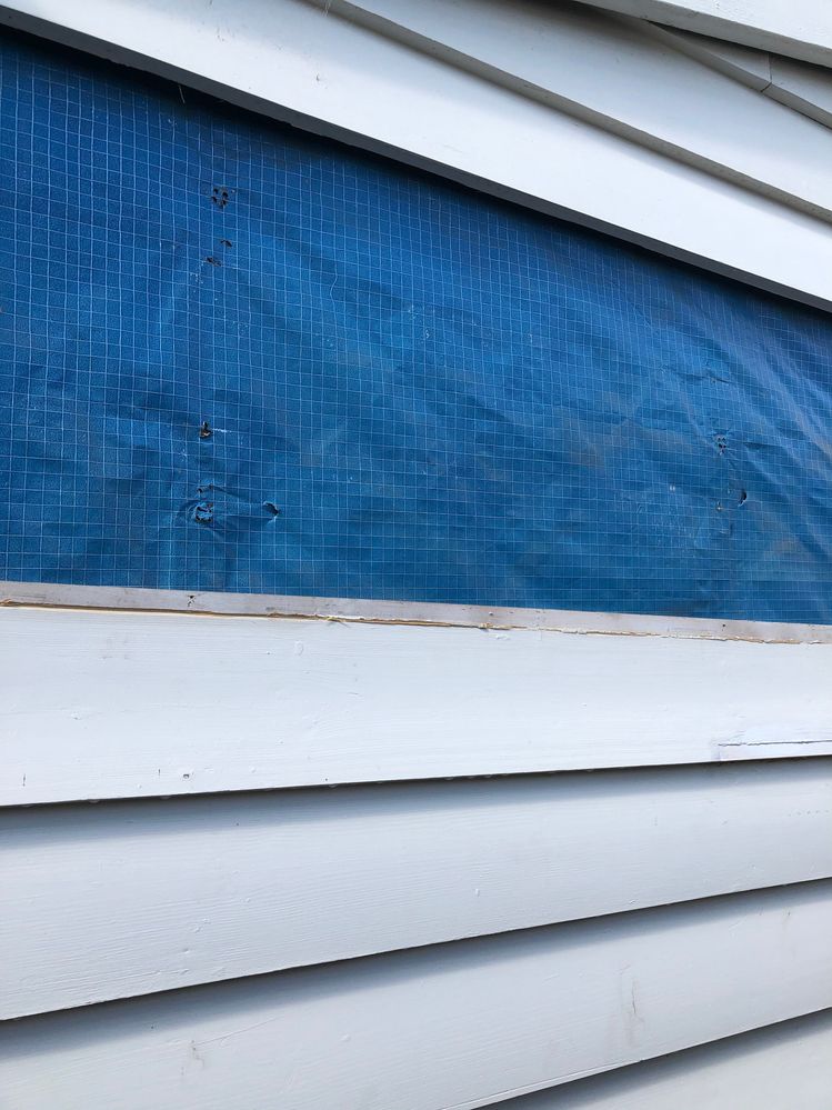

I am currently working on overhead cupboards for my laundry, as we all know, you can never have enough storage space. I have already built the carcasses and the doors, they are made from tassie oak with glass insert, (glass is on order).
I found out that I don't have enough studs behind the plaster wall, (using a Stanley stud
locator) to mount the cupboard securely, so I had to install extra studs.
Started by marking out area where cupboard is to be installed, then remove the weather boards, foil wrap and insulation.
I used 95 x 45 pine to frame up the area, (a bit of overkill).
Reinstall installation, foil wrap and weather boards.
Now I can go back and finish off my cupboard, I will keep you posted.

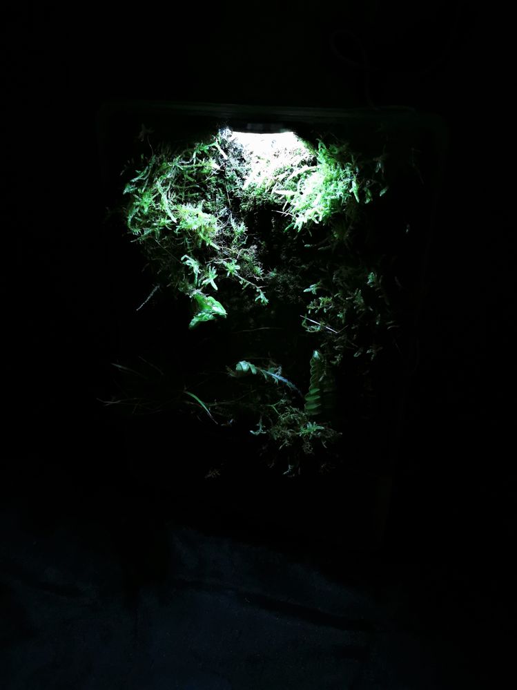

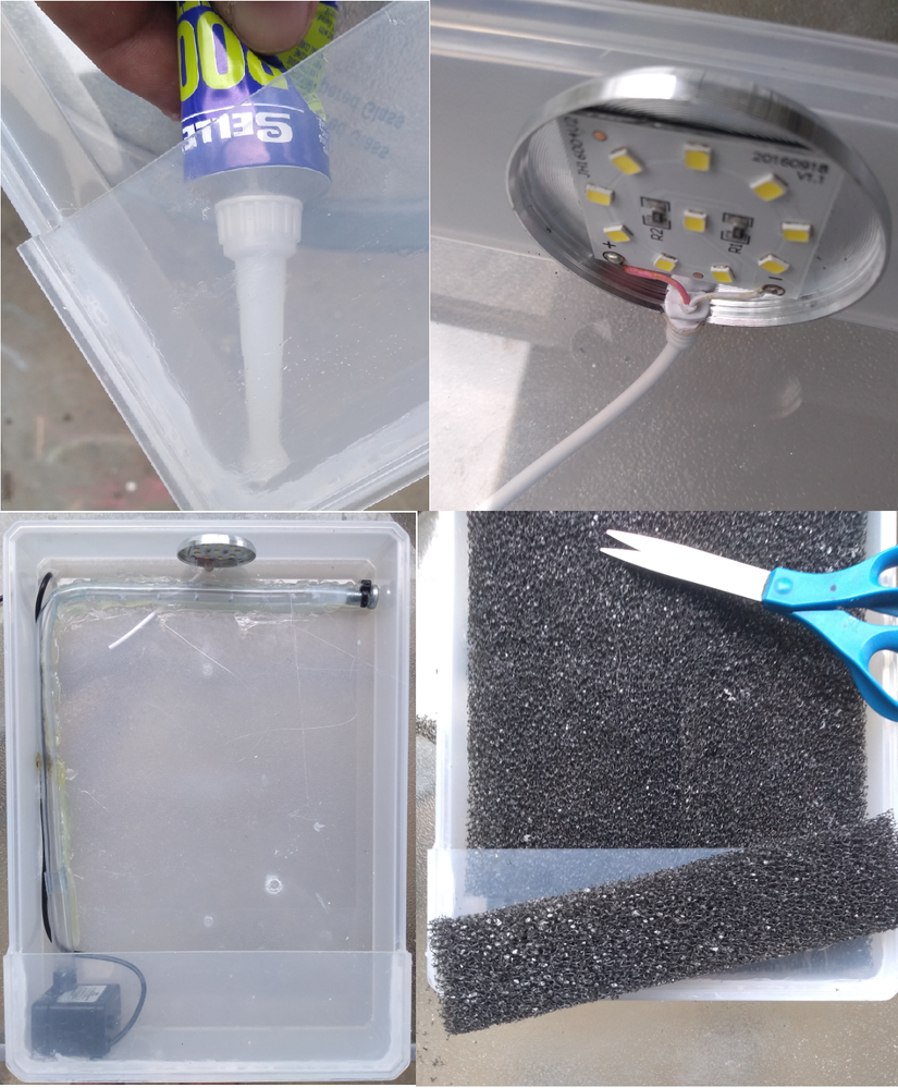

I've just finished my mini desktop self-watering moss wall inspired by SerpaDesign. I absolutely adore moss and ferns, so I jumped straight on this project when I saw the video. It was fairly simple to make and only took an afternoon with all the parts coming straight from Bunnings.
I know you'll love this one @mich1972😀
It would be fantastic to hear what everyone is working on this weekend.
