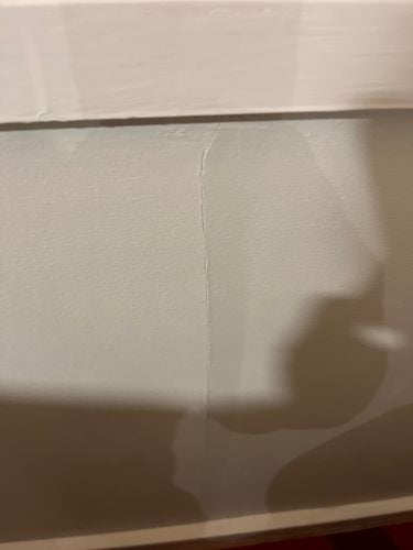

looking for some advice on how to DIY fix this.
bulge is under a window where 2 sheets of plasterboard meet. Has been like this for at least 5 years with no changes, but I’m just sick of looking at it.
the bulge is quite obvious. No issues with plasterboard above the window.

There are two main reasons I can think of that there would be a bulge in the wall.
The first is that the joint in the plasterboard was not recessed, so the compound is bulging out further than it would be in a normal plasterboard joint.
You can see the slight shadow at the front edge of this plasterboard sheet. It is a very slight recess that allows for jointing tape and layers of plaster. If the plasterboard was cut so that this join didn't have a recess on each side, the plaster and tape would not have a recessed area to sit and would consequently bulge out.
The other potential reason is that the timber stud behind the plasterboard is out of line with the other studs, so the plasterboard itself is bulging out, and the plaster applied over the top has magnified the issue.
Depending on the severity of the bulge, which is very hard to see from images alone, you could try making a relief cut on each side of the bulge, peeling off the plaster compound, tape and paper face of the plasterboard, then using a plaster rasp like this Intex PlasterX 140mm Block Plane Rasp, to create a recess in the plasterboard that you can then apply a base coat of Multi-Purpose Joint Compound, mesh jointing tape, then a topping coat. Allow it to dry, then sand smooth with a sanding sponge before priming and painting.
The other option is to cut the plasterboard back to the nearest stud on each side, assess whether there is a bulge in the stud, and plane it back if needed. You would then need to install a new sheet of plasterboard following the same process to create a recess on each edge of the plasterboard, apply the compound, tape, topping coat and then sand, prime and paint.
Unfortunately, there isn't a simple solution. You could try simply sanding back the bulge and applying some multipurpose compound over the crack, but I doubt you'd be able to entirely sand out the hump.
Allow me to tag @Nailbag to see what he thinks.

There are two way to repair this. The first is outlined by @JacobZ whereby you're essentially sanding down the high-side flush to the low side. Applying a tape over the crack, and then applying a skim coat over the area in 2-coats with a light sand in-between. The 2nd covering twice the area and sanding when dry, featuring it out to where it meets the existing wall. Just a note on the tape to use my understanding the recommended industry tape to use is paper of fibreglass mesh.
The 2nd method, is to build up the low wide level with a base coat, then tape, then top coat. Its an easier less messier process, but both methods will result in the same finish in the end.
With either method since the bulge is on a facing wall you won't notice there is now actually a smooth rise over flush, but it's over a greater distance.

I personally would start sanding the bulge down and see if there is an issue or if the person who originally did the job just did a bad filling job and never sanded it back.

Depending on how much the buldge is, say its 2mm ish, you could smooth the area over with plaster and then sand smooth, so I am talking about the whole width between the window frame and that other edge. I had a similar buldge in a spare room (previous owners kids had been bouncing around id say and a rubbish repair job) and I tried sanding it flat but was starting to go through the paper of the plaster sheet, so I extended the bump in effect, instead of a short sharp bump that you have now, make it a long smooth bump that teh eye and hand dont see. say 30cm on the low side smoothed up to almost the bump height and then down 30cm on the other. As you sand it the tip of the buldge will smooth out.
Just another option to consider. :smile:
