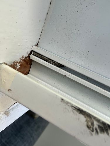

Hi I have a piece of metal that runs along the width of a window that I need to remove. It appears it is only held in place by 2 screws at each end, otherwise I think the piece of metal just sits flush against the window frame. The screws are in channels - see picture. What’s the best way of removing this? Was thinking a multi tool could be used to cut through the screw? Any advice ?

A multi tool is a very handy tool especially for tight inaccessible spaces. If the screw is in an inaccessible spot and you will no longer need it to be reattached, then cutting the screw with the multi tool is the way to go. However, if reinstallation is in the cards, then I suggest further investigation and see if removing parts of your window frame will allow you to access the screw for removal.

Thank you! Thats right I don’t need anything to be reattached, just removed. So I’ll grab a multi tool - any recommendations? Thanks very much

I am wondering what the other ends of the screws are like? Is there any chance of removing them over cutting them off? A multitool is still going to leave a mark on the piece you remove plus its next to a window as you say, vibrations around glass I would hesitate and leave to the last option type deal.

the other ends are in the timber frame I presume they are headless because it screws into the actual framing around the window. The metal channel the screws are visible in is very difficult to manoeuvre around, unless there is bashing and brute force but as you say the window is right there.. so that isn’t a real option. Ive tried jamming a flat head screw driver in and using mallet to see if the metal lip moves but it didn’t budge. Would padding the glass area that close to the screws with towels etc make a difference to minimise vibration from the tool? I’ve not used a multi tool before

Yep spot on using the multitool, but you will need a decent metal cutting blade, which aren't cheap. But this Diablo one I can vouch for, but in the long run is better value for money due to longevity over many others I have burnt through litterally.
Run the tool at around 3/4 speed so not to heat it up to much and don't apply to much pressure and it will cut through relatively easy.
