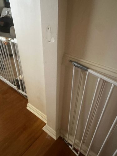

I have a child gate near the entrance of the front door small hallway my amstaff kept jumping on the gate and has made the screw hole bigger than the original hole how do I fix it and what with

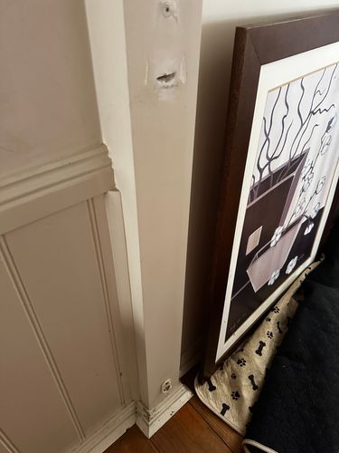

I’m not going to put another gate in the same spot just I just would like to repair the holes I got another gate from Bunnings today to put a little further away from that spot what would I need to repair that big hole that was once a small screw hole now just a big one that looks like a smile
Hi @clarke72,
If you are just looking for guidance on how to fix the damaged plasterboard, then you can use this handy guide on How To Patch A Plaster Wall.
Let me know if you have any questions or need anything clarified.
