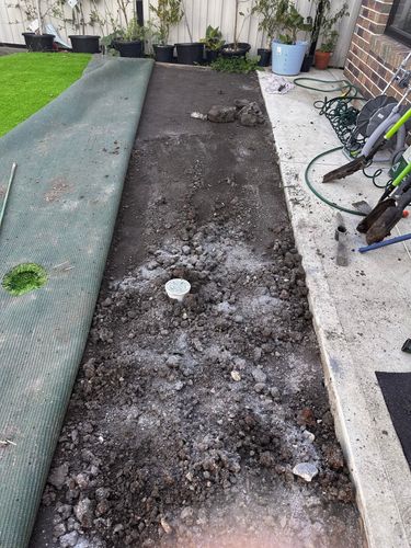

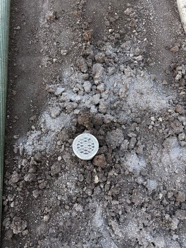

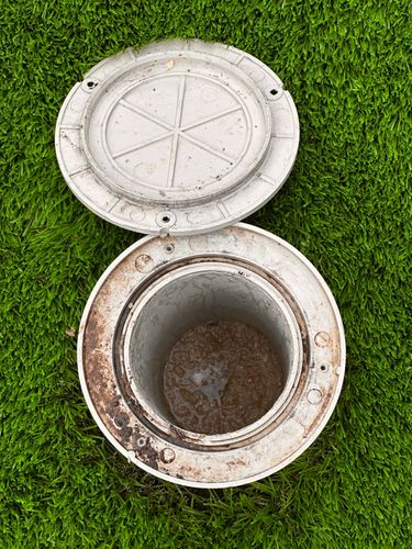

After doing some more inspection around the house, I found that the backyard drainage pipe was completely full, showing signs that drain couldn’t pass through. On Friday, I tried cleaning it using an Ozito wet & dry vacuum. It turned out to be a pretty tough job — I had to manually empty 13 –15 buckets (20L each) from a 2m hole. The water finally started flowing slowly after that, but unfortunately, the same issue came back very next day.
I then purchased a Josco drill-powered pump to try and remove the water more efficiently. Initially, I had trouble using it with my regular Ozito drill/impact driver, but it worked like a charm with a hammer drill. This mini pump was a lifesaver and definitely a great buy.

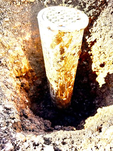

Once the water was cleared from the downpipe, I used an Ozito pressure washer to flush out the dirt and debris underneath — that also helped quite a bit.
At the moment, water is flowing through the pipe again, but I suspect the issue might return. Because I noticed what appears to be some toys stuck hard inside the drainage pipe. The current Ozito vacuum isn’t powerful enough to suck them out.

I spent some time today and was finally able to fix the issue. Here’s what I did:
  1. Dug around the downpipe — about 500mm deep and 200mm wide
  2. Cut the pipe using a Craftright junior hacksaw

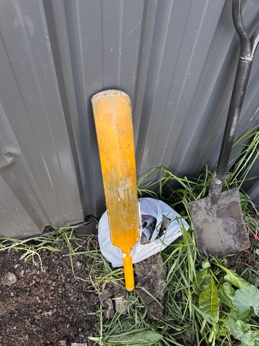

  3. Luckily, I managed to reach and pull out the handle of a plastic cricket bat (around 400mm long), along with a few other items — 1 tennis ball, 1 rubber ball, 1 small slipper, and a long plastic straw
  4. Rejoined the pipe using a 100mm PVC pipe coupling slip
  5. Refilled the dug area with the soil
Finally, happy that it’s fixed — and fingers crossed there’s nothing else left inside!
