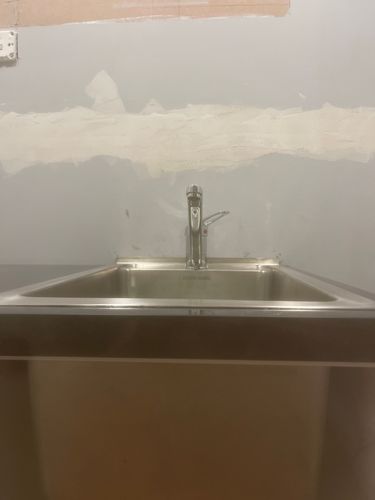

Thanks Eric, yeah I meant to get to it haha, attached is the base cabinet and the laundry unit that the counter would cover

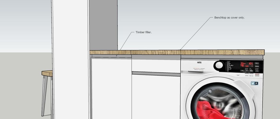

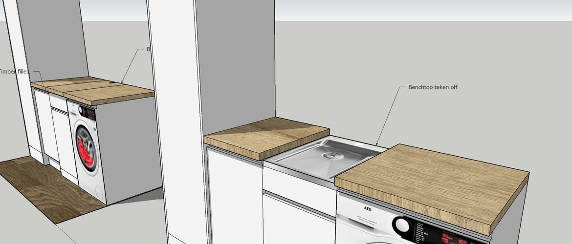

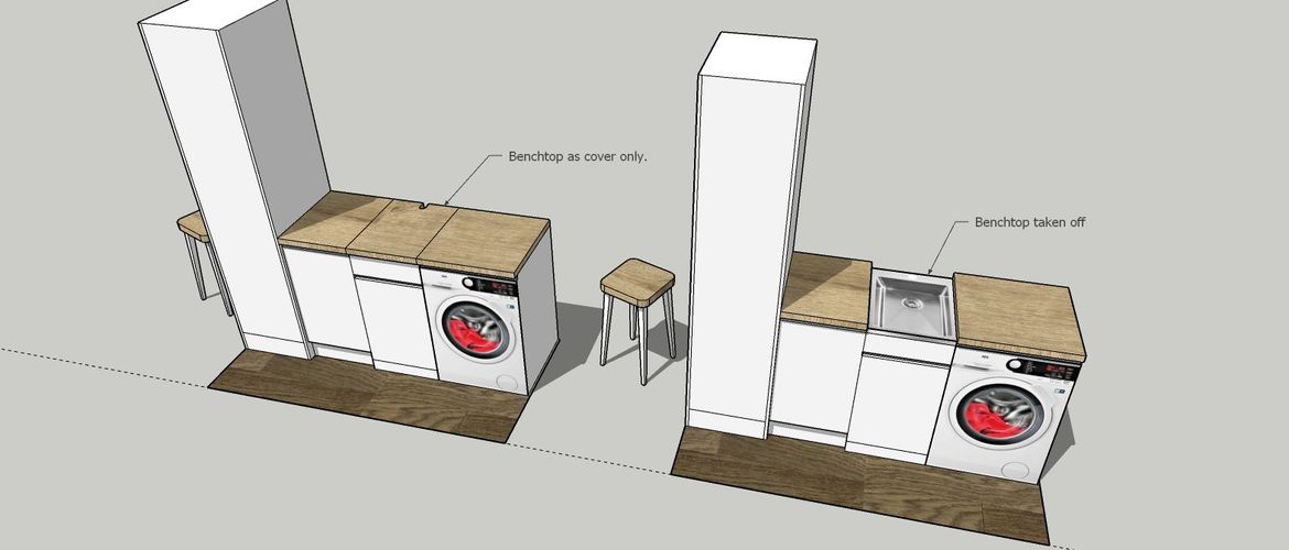

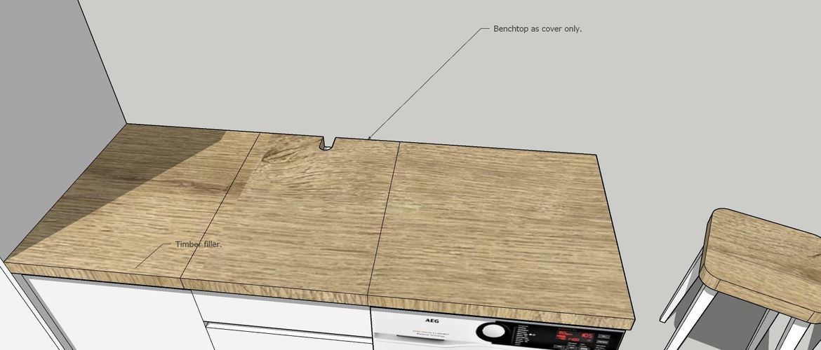

Thank you for posting a picture of your cabinet layout. I suggest raising the height of the base cabinet to the level of the sink tub. Place the benchtop on top of the cabinet and cut it straight along the right perimeter of the base cabinet. Then on the other side of the benchtop cut along the perimeter of the laundry tub.
Now you're wondering, why would you need a benchtop for the top of your laundry tub? You don't, it's actually just a cover to give your laundry a seamless look. The benchtop for your laundry tub needs to be cut at the top so that you can push it all the way in and avoid the laundry tap. You just need to take that benchtop out whenever you want to use the laundry tub. Please keep us updated, we look forward to seeing your laundry once it's complete.
Let me tag our experienced members @craftyhopper and @prettyliving for their recommendations.
Re: Cut out in Kaboodle countertop over laundry unit
Hello @PrideKnight
My apologies for the late reply. I just realized that I forgot to upload the pictures for my suggestion. I hope its not too late, please have a look.
Pride benchtop1.jpgPride benchtop2.jpgPride benchtop3.jpgPride benchtop4.jpg

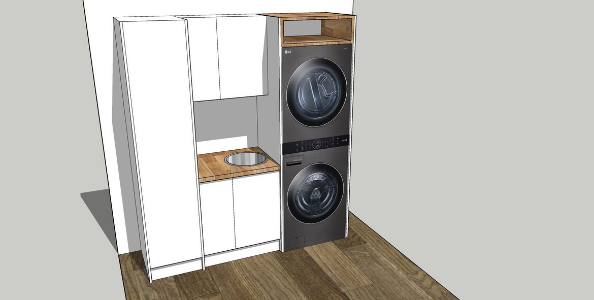

I've reworked the drawing with your LG washtower and 450 base cabinet. If you wish to see it in another configuration, please let me know.
