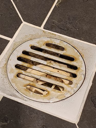

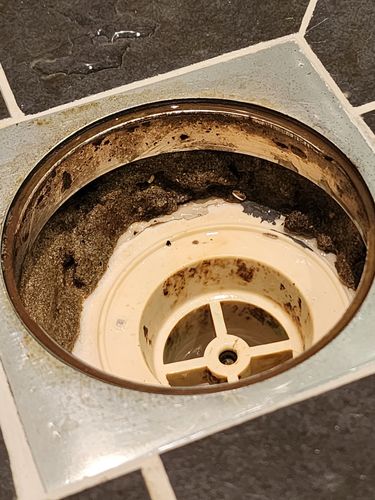

I have a potential slow shower leak manifesting as bubbling paint in the ceiling below our bathroom shower.
Today, a shower leak repair service inspected and said the builder who did our bathroom has not installed the shower drain properly. The white drain should be up to the level of the tiles without the cement screed visible. He thinks that water may be tracking through the cement potentially under any waterproofing. He found that the grouting and silicone all looked good so he doesn't think they are the cause. A plumber who was also present fixing other things agreed that the shower drain should not have been installed like this. He said short of redoing the entire shower I needed to find some way of making the water flow directly into the centre of the white drain without going onto the cement. He didn't have any ideas of funnel shaped pipes to achieve this.
I am scouting for possible fixes. One idea that came to my mind was to use an epoxy putty eg Selleys Knead It Aqua or PC products PC Marine Epoxy putty to mould all the way around from the lip of the metallic shower waste, just below the grate, almost like a funnel to just inside the raised ring of the white shower drain.
Could this be a fairly watertight solution between the waste and the underlying drain that stops water tracking into the cement? Can I assume the putty to be watertight when dry? While this is a potential cheap DIY fix, would any of this potentially make things worse?

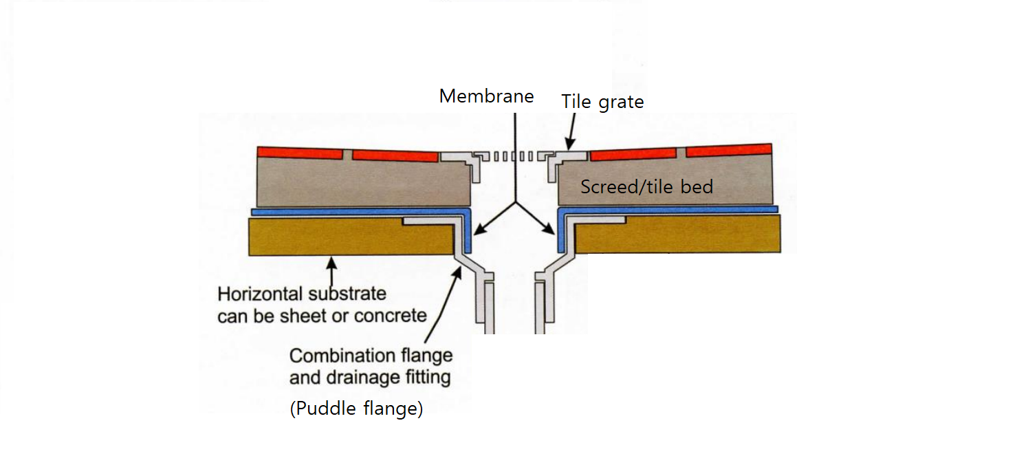

I'd get a second opinion from a waterproofer. I don't believe that is correct, but I'd be happy to be wrong. The puddle flange goes on the bottom, where it is with the waterproofing membrane, and then the screed/tile bed. The screed is a wet layer as moisture passes through the grout, down through the screed, hits the waterproofing membrane, travels along it and into the puddle flange. If the puddle flange (white drain) was at the same level as the tile, then the water draining down through the grout into the screed would not be able to enter it.
I'm sure there are drains these days that are designed to sit flush with the tiles and then have a secondary port lower down to capture water that hits the membrane, but in your case, I think it is installed correctly as per the diagram below. Further to this, you cannot seal between the tile grate and the puddle flange, as this would prevent the water collected on top of the membrane from entering it. You'd stop the membrane from doing its job, which is to collect and funnel the water to the puddle flange.
This doesn't mean there's no leak, the membrane could be compromised, but it's not at the point where you see exposed mortar/screed/tile bed. Water should be able to go in and out of there without causing issues.

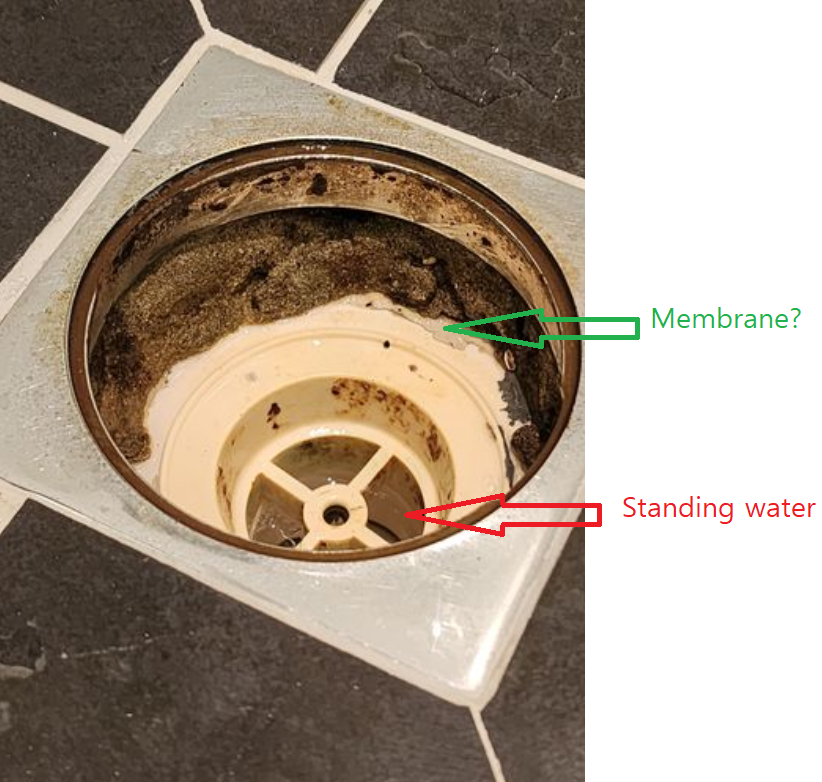

What I do note is you have standing water in the puddle flange. Was the leak detectorist running a test at the time of the image? You shouldn't be able to see water sitting there like that. It should be lower down out of sight in the trap. If water is standing that high up, it could be finding its way out of the pipe joint, below the puddle flange and into the ceiling below.

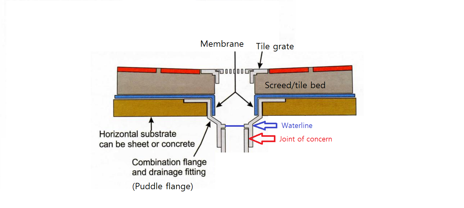

I've marked in the image below what could be the membrane and also what appears to be standing water in the vertical pipe. Do you have any idea why the pipe is full to the top? I'll also include a blue line on the cross-section diagram to show you where that water line is. If the joint is submerged, water can enter the ceiling.
My priority would be determining why the water is standing there in that pipe.

Which brings me back to my original thought. Is it worth trying as per my original post to putty up the sides of the drain completely around 360 degrees. In your diagram this would be from the tile grate to inside the flange near the raised lip in my original picture. I would only try this as a nothing to lose remedy before calling in the experts if it didn't work.
