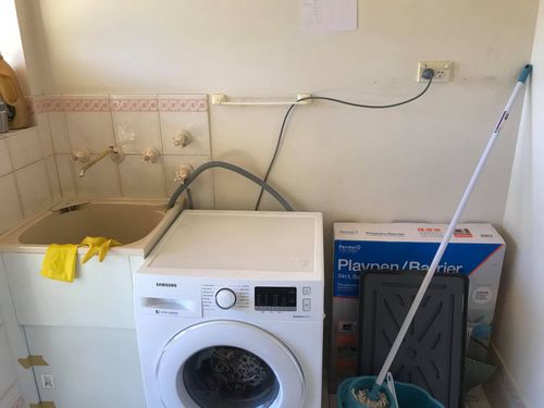

Here's a photo of my ugly current laundry for reference:

It's great to see you have a couple of different projects on the go. You should find this step-by-step guide helpful: How To Create A Cut Out For Sinks And Cooktops. Regarding the pipework, you might find it easier to cut the existing pipework off and install a new Caroma 50mm P Trap at the correct height for the new sink. This would most likely be easier than trying to adapt to the existing trap. Once you have installed the trap, it is just a matter of screwing the couplings to the sink waste.

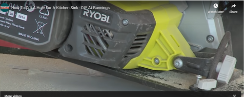

After measuring something like a thousand times, I eventually built up the courage to drill four corner holes and connect them with the jigsaw - very, very slowly.
Clearly you can make those cuts quickly, as seen in Mitchell's video, by the "Drop Method" using a circular saw - but just looking at it, brings beads of sweat to my balding head. One slip and it's ruined.
