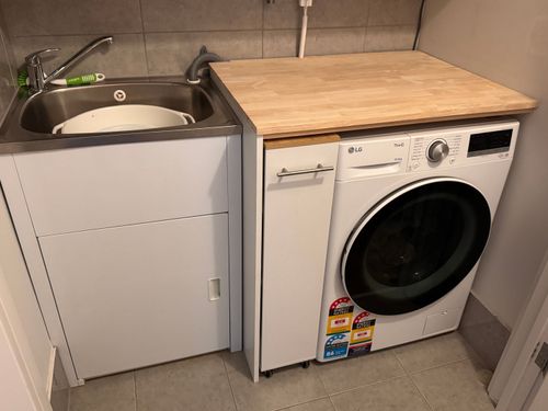

I am in a rental so limited to what I can do. I have a small laundry and wanted to add a bench too. Is there anyway that I can fit a bench top without drilling. I am sure that if I get a bench top and sit it on top of the washing machine it will probably slide down the broom cabinet side. How can I make this a bit more functional bearing in mind it is a rental and would want to dismantle it once leaving the property.

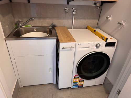

well I managed to finish the bench and sink cover (minus oiling as that will take a couple days). Absolutely love it 😊 Before

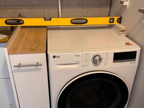

Making the bench over the washing machine

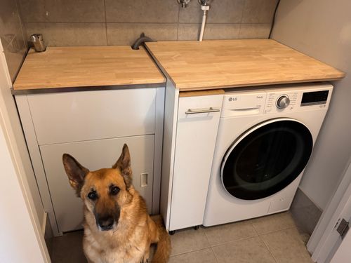

Bench finished

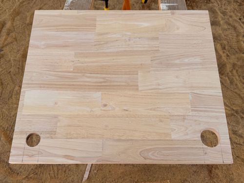

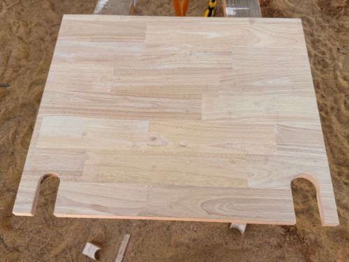

Making the slide out sink cover
Sink cover finished
Whole project + my doggo

I really like this idea. I may have to put a laundry sink cover on now also. Was that just a slab to sit on top that can be easily removed?
Hi @sareh

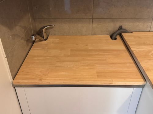

yes it’s just a slab that sits on top of the sink and slides off. I just measured the sink then measured where the taps were and used a hole saw and jigsaw to make cutouts for the tap and washing machine hose. Then place on top of the sink and slide it in
