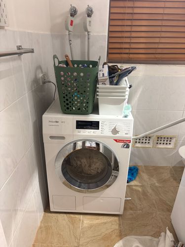

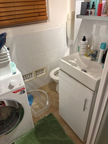

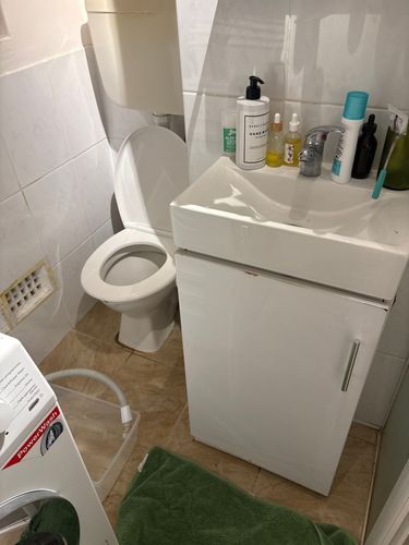

Hello, my bathroom is tiny with a shower, a small sink and washing machine taps and toilet.
Ive connect the wash machine but have nowhere to put the waste water hose.
i believe it is not compliant to put the hose in the same sink that I personally use. And, this sink is too small. Some suggestions would be great.

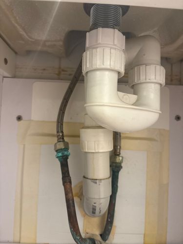

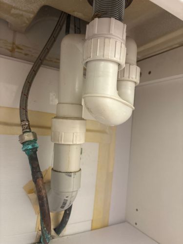

Here is a picture of the current pipe set up under the small sink.
Re: How to connect washing machine waste hose in tiny bathroom?

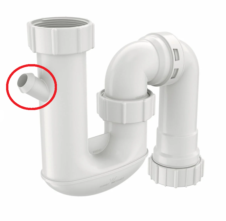

You would need a plumber to change that setup over for one like this Caroma 50mm White Combination S And P Traps With Dishwasher Connection @Nell95. That way, you'd be able to push your waste hose onto the barb marked below. If you do go that route, ask the plumber if they can drill out the barb ready for you to use.
