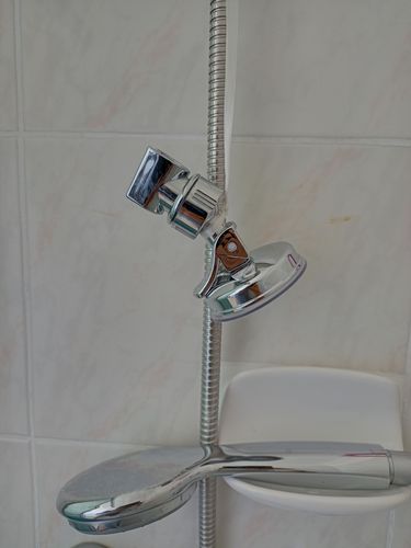

Good morning, the self stick
shower head holder dropped off after being used for a few months. I've tried to put it back, but it dropped off again after a while. How can I fix it back tightly? Thanks
Re: How to fix a self stick shower head holder tightly without dropping off
Hello @sumleung33
I suggest trying this method. Identify on the tile where you wish to place the suction cup holder. Wipe the surface of the tile dry and then apply DIGGERS 125ml Isopropyl Alcohol and wipe it dry with a paper towel, do not use a tea towel or rag. Next wipe the rubber section of the suction cup with the isopropyl and make sure it is totally dry. Place the shower head holder in the open position and push the holder onto the tile firmly. Once the suction cup adheres to the tile lock the shower head holder into position.
This should keep the shower head holder firmly in place. If it falls again simply wipe the surfaces with alcohol to dry the surface. Do not use methylated spirits or any other cleaning product as they leave a film on the surface of the tile.
