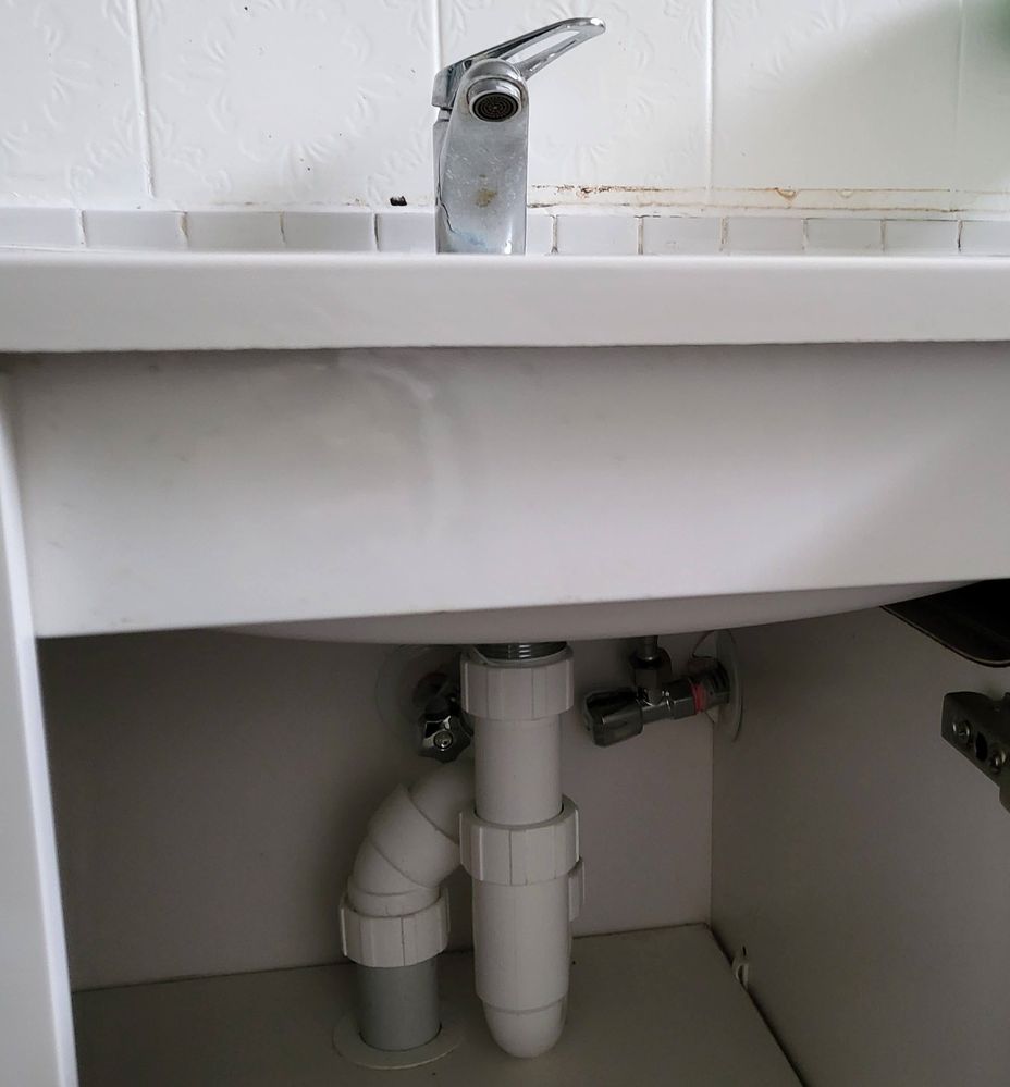

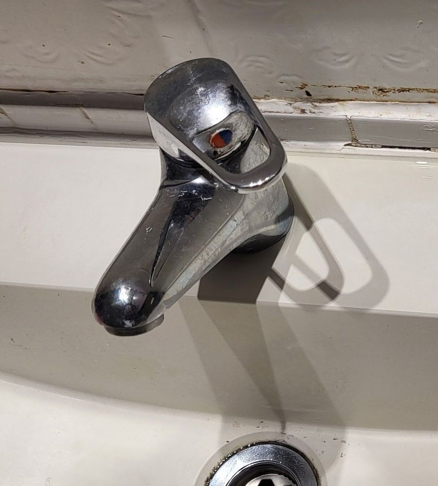

Hi Community,
I've encountered a strange issue with my basin tap. Water seeps around the tap quite quickly, even though I've shut off the hot and cold water supply valves below. I'm trying to determine whether I should replace the basin tap or inspect for further leaks.
My confusion arises because, despite turning off both the hot and cold water supplies (with no water coming from the tap itself), there is still seepage around it.
Any advice on why this might be happening and what steps I should take would be greatly appreciated.
Thank you!

Thanks for sharing your question about your basin tap. The leak is probably originating from the ceramic cartridge of the tap. Even though you've turned it off, water is bypassing the cartridge and passing through the sides ending up on the top of the basin mixer and overflowing.
If you are familiar with basin mixer repairs, it might be possible to replace the cartridge of your mixer with a generic set. However, you also have the option of replacing the entire basin mixer.
