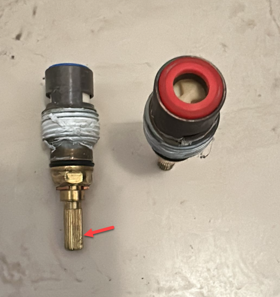

I bought a Mondella Resonance chrome pin lever wall top assembly with 1/4 turn ceramic disc valves installed in my shower (hot and cold wall taps) from Bunning 1 year ago.
The shower is leaking when turned off, and I believe the ceramic disc cartridges/spindles need replacing.

Hi @alwin,
Yes, there is a good chance there will be compatible replacement spindles available, and this would be the best place to start.
Matching up the size and shape of the spindles is important, so it is always easiest to do it physically. My suggestion is to take the spindles in the store with you and speak with the team in the plumbing section. They will be able to help you compare and locate compatible 1/4 turn ceramic disc spindles.
If you can't locate spindles in store, it looks like these Mondella 1/4 Turn Ceramic Disc Spindles, which are a Special Order line that would need to be ordered, are very close to the size and shape of yours. While in-store, the team will be able to assist you with confirming their compatibility and ordering them.
but that one is Basin not shower one, you sure they are compatible?
Hi @alwin,
To me, your spindles look like basin spindles, rather than wall spindles. Wall spindles tend to be longer as they need to account for the thickness of the wall sheeting and tiles.
These are the only 1/4 turn ceramic spindles I could find that look like yours, with the splines on the spindle key and shorter in length.
We can check against the dimensions, 64mm tall and 23mm in diameter. Can I trouble you to measure your spindles and let me know what the dimensions are?
