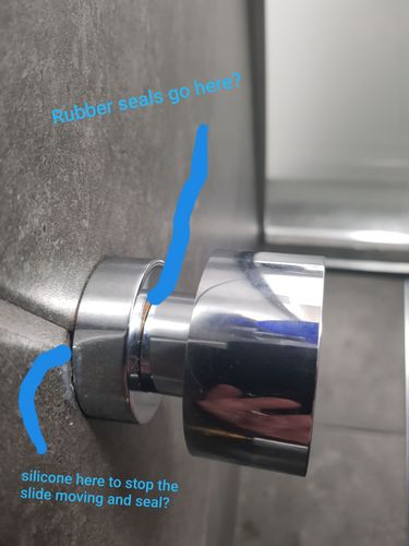

I've bought some new taps for our shower. The spindles were too short so I bought some ceramic disk spindle extenders. It doesn't leak but I'm stumped as how these flanges are supposed to fit.

I believe my colleague was possibly referring to the spindle locking nut. It is adjustable, but I'm afraid it might not help in your current situation. My next suggestion is to use a rubber seating washer as a spacer to raise the level of the Mondell flange.
Place at least 2 rubber seating washers first before putting the original flange on top. Mark the outer diameter of the flange with a pencil. Remove the rubber washers and trim them down with a sharp Stanley knife. If the height is lacking you can add more rubber washers, it's an easy alternative rather than putting in silicone. In this manner, you can still remove the flange and not have to cut silicone out.

I was thinking more behind the flange rather than in front of it. The flange actually has an internal O-ring that seals against the body of the spindle. So I was thinking that we just need the flange to move forward so that it is on the body of the spindle cover. Have a look at the sketch below.

My only concern is that the flange isn't secure. It's held in place by an o-ring that provides slight friction against the spindle body (sleeve - Mondella) and is easily moved forwards. Even with rubber behind the flange, the flange will still move forwards.
I don't understand how it's secured to the wall. It slides up and down the sleeve. Starting to think I've either installed these things backwards, or I'm missing something.

Just to put your mind at ease, you've installed it correctly and there are no missing parts. To my understanding, the flange only serves as a cover for incidental splashes from the shower. However, if you wish to seal it to the wall, I'm afraid your only choice is to silicone it to the wall and seal the gap between the body of the spindle cover.

If I could get a rubber washer about 2 or 3mm thick (or a small square of neoprene) cut it to size and place it behind the flange I could silicone both to the wall with some grey silicone. It'd secure the flange and cover the gap between the flange and slide.

If you put enough silicone on top of the rubber piece it will form a seal on top of it. However, it will not bond to the rubber surface if that's what you're asking. So in essence any bathroom silicone sealant will work, just make sure that you apply enough of it to form a proper seal.
With the rubber behind the flange will it provide enough adhesion between the tiles and the flange to prevent the flange from moving? I'm thinking yes but I'm not sure.
