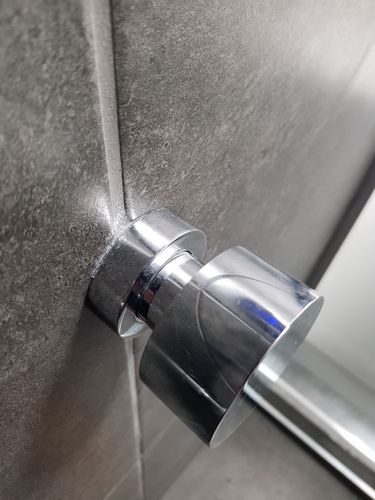

I've bought some new taps for our shower. The spindles were too short so I bought some ceramic disk spindle extenders. It doesn't leak but I'm stumped as how these flanges are supposed to fit.
Any help is appreciated!

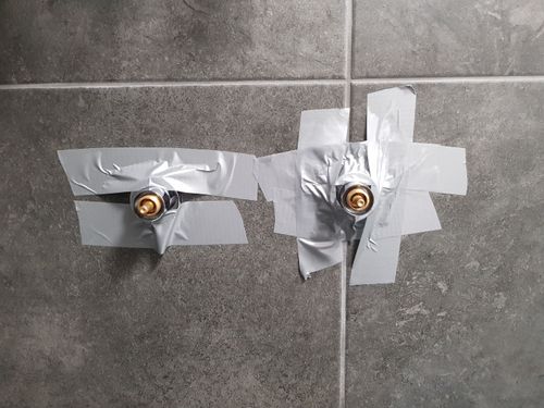

I've siliconed the flanges to the wall (to stop them spinning or moving forward) and placed some silicone in the gap. Masking tape wouldn't hold the flange against the tiles while it cured so I used gaffa tape.
I am concerned that the tape will stop the silicone from curing (especially where there's grout and a slight difference in tile depth) but it won't do any damage. I'll give it 24 hours, gently pull it off and see.
Hi @Aneil
Thank you so much for the update. I totally agree that you should take the gaffa tape off slowly to avoid damaging the seal. Most silicones are air-activated so even just a little exposure will start the curing process.
Please keep us updated with your progress, we look forward to seeing the final look of your shower taps once the silicone has cured.

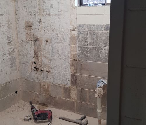

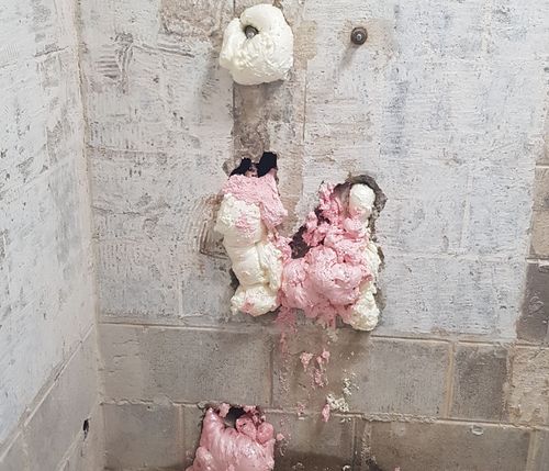

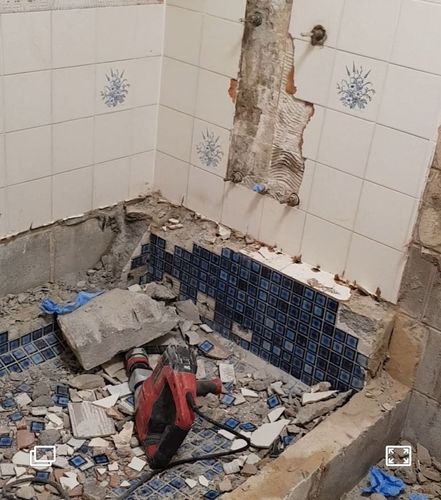

Before
During
After

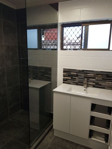

Almost finished. Just waiting on a mirrored shaving cabinet to cover the majority of the window.
Hello @Aneil
What an amazing transformation. Thank you very much for sharing those photos of your bathroom renovation. The tapware came out very nice and the silicone sealant is very well hidden. The re-tiling of the shower area has made the entire bathroom look so much bigger. Plus the large tiles really give it such a modern look.
