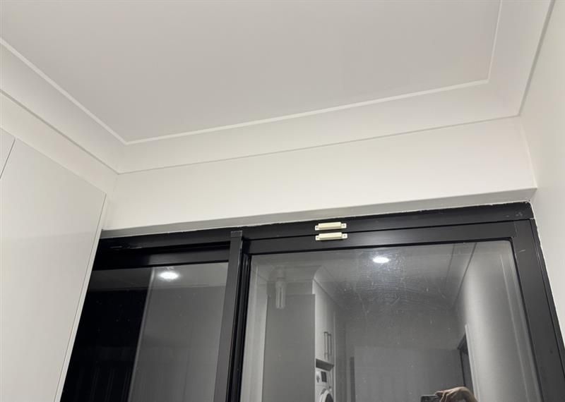

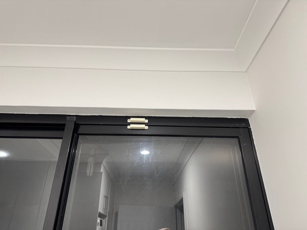

Is it possible to get a photo of the location where you're looking to install the curtain from the front? Is it a bulkhead/pelmet? Or is it the ceiling?
It looks like it is a bulkhead, which, due to the physics involved, can't be masonry, so we can reasonably assume it is either timber or steel framing with plasterboard over the top. It likely feels hard because there needs to be a framing member running along the outside edge, so you are probably tapping on a stud. Once you can upload a photo showing it from the front, I would be more confident making this assessment.

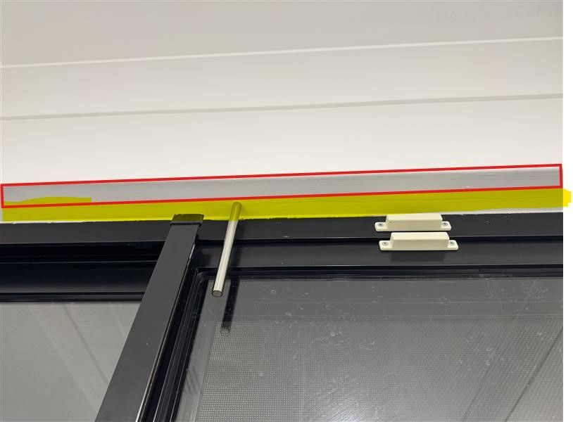

Hi @JacobZ
Thank you so much for your detailed response.

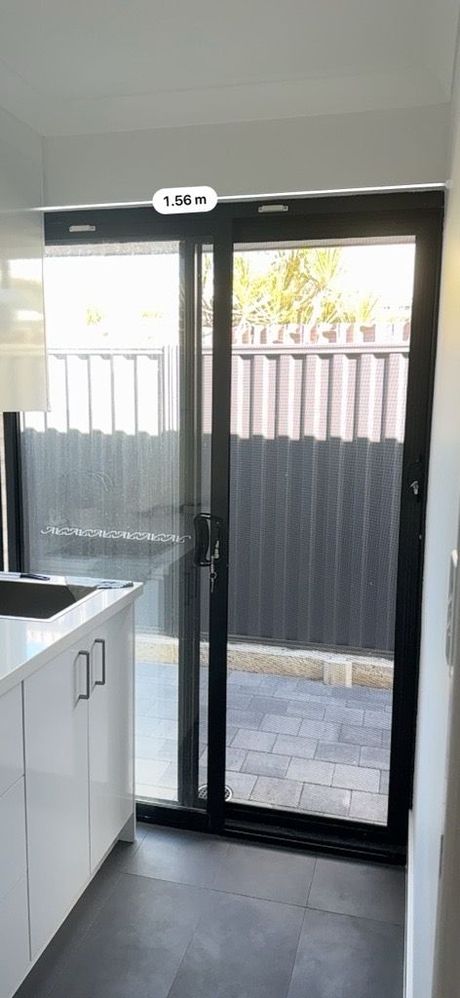

I have attached more pictures for your reference.
This is more like a door frame. I am not sure it is a bulkhead or pelmet designed for curtain installation. I feel like no.

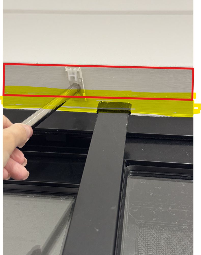

I have tested with a magnet. The yellow area is metal. The red square are is not. I would like to mount the attachment to the red square area, but it may reach to the yellow part (metal part) a bit.
Thanks again.
Hi @newnewworker,
You can use a multi-material bit in non-hammer mode in your drill. Drill slowly and it will go through timber, concrete and metal.
Remember that glass can shatter easily if knocked, so take care when working around it. Ensure you wear safety glasses, cut-resistant gloves, a long-sleeved shirt, trousers and enclosed shoes.

For the track mounting,
the yellow part is metal. If I drive screws there, I need metal screws only, no anchor.

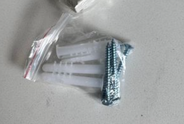

The anchor and screws provided by the curtain seller won't be used.
If I mount on the red part, which is not metal, I need the given anchor and screws.
Am I correct?
Hello @newnewworker
Yes, your assessment is correct. Metal screws for metal surfaces and anchor plugs to plasterboard surfaces.
