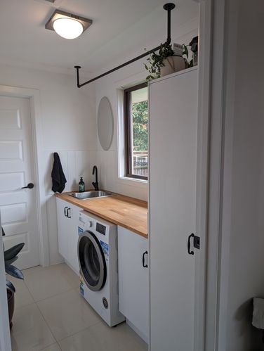

 Well it's been a while that's for sure. I got this laundry to a functioning point then lost my mojo to complete the finishing touches. Finally over the Xmas break I did it. Had to get in the ceiling to put in cross beams in so I had something to attach the rail to. Added a small oval mirror that I found on Temple and Webster. Used 6mm quad around the bench and 9mm on top of the VJ. So happy with the end result but kick myself for taking so long to do those finishing touches.

What a sensational result @Jobey! You must be so pleased with how well that turned out; kudos to you!
Many thanks for updating us with the finished laundry, as I trust it will bring great inspiration to anyone who comes across your project here.
