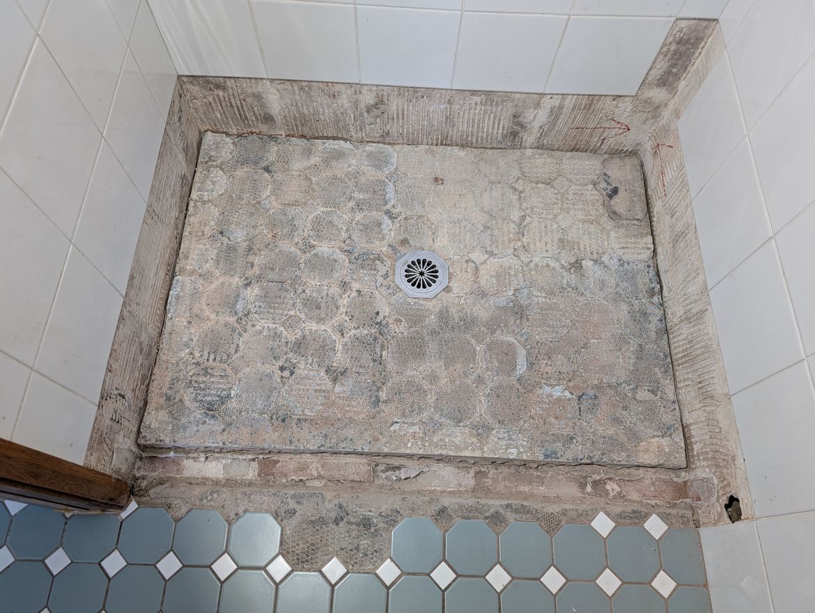

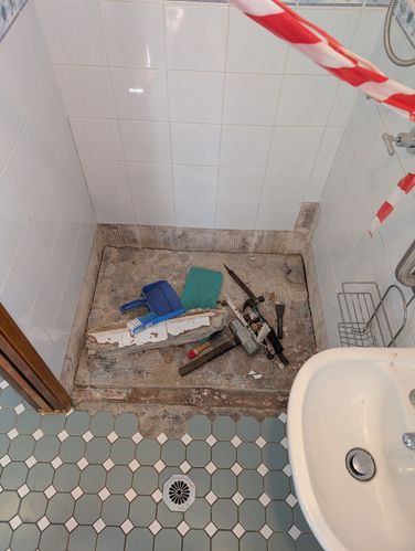

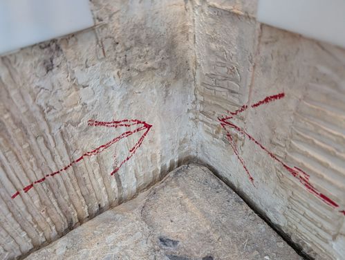

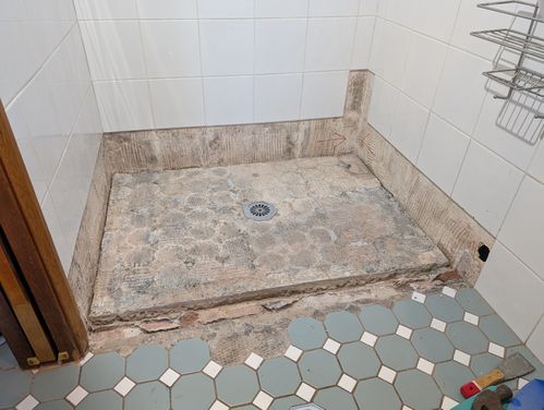

This bathroom was constructed 31 years ago at my single story home. Recently I noticed wet and damaged subfloor timber under the corner marked with red arrows. Damage below will be dealt with. My objective here is to remove the hob, repair the leak, and reinstate the shower, with a narrow (200mm) acrylic panel to protect the timber door frame. I do not want a full shower screen or curtain. I still have a few boxes of those wall tiles in the back shed, and I can source adequately-matching floor tiles. There is clear evidence of original water-proofing around the hob, I saw no evidence of original water-proofing on the leaking side, although it maybe hidden by the screed. The screed level inside the (former) hob is 15mm higher than outside.
I attached 3 photos indicating my current status.
How should I proceed?

I want to clarify. My reason for removing the hob is to eliminate a safety hazard which becomes significant as I grow older. My home is not an apartment. It is a single-storey federation house in an inner Sydney suburb adjacent to a train station. A rear extension built in 1994 accommodates the subject shower. This neighbourhood is earmarked for high-rise development and the developers are circling. Nonetheless I'm hopeful to live out my life in this home. As an age pensioner, my liquid financial resources and my physical strength are limited. My awareness of building codes and my DIY skills are moderate, although I have never done waterproofing.  I have time on my hands so would like to do this project myself.
I have toyed with prefab tray and wall solutions, but I am inclined to proceed as follows:
  • Scrape out residual debris around the shower perimeter
  • Make good the subfloor timber damage to ensure the FC substrate is fully supported.
  • Fill with cement/screed the void created by hob removal, strategically shaping the new surface.
  • Pack deeply with silicone the gap along the 3 enclosed sides.
  • Apply waterproofing to the cement floor and exposed walls.
  • Retile the bottom of the walls, then retile the floor.
  • Fit acrylic 200mm vertical strip to protect door timbers
Will such a solution hold up for 10 years? Can it be improved for minimal new effort? Or is it a bad direction?
Let me know please.  Thanks again

Thanks Mitchell for very relevant advice. One question comes to mind. We can see there is a fair amount of surface residue on the exposed floor and wall boards after tile removal. To what extent must I scrape back and smooth off those surfaces before waterproofing and retiling?
Re: How to remove shower hob and fix leak?
Hi @Roq,
You'd want to remove all of the old tile adhesive so there is a flat, clean surface for the waterproofing to bond to.
You can use a chisel or paint scraper to remove the majority of the adhesive. You could then use an angle grinder with a flap disc to remove the more stubborn stuff, ensuring you wear gloves, long protective clothing, ear and eye protection and a mask while doing so.
