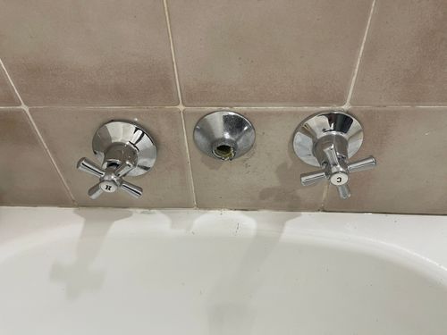

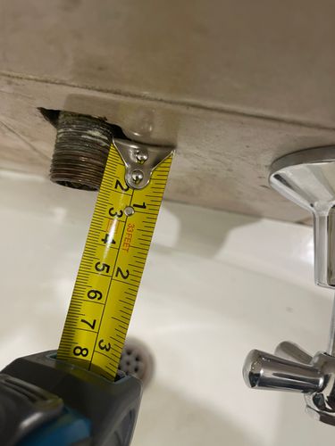

Hi Team,
bathroom spout is stuck and wont not budge -
tried WD40 and Heat but it wont move.
Sliced bahind flange just in case there is any slicone but there is no slicone adhesive.
seems like a centre part is holding onto
do I need to cut flange with a grinder ?

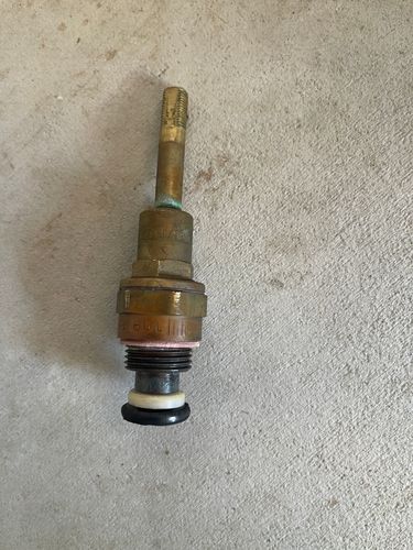

second issue:
spindle is bit shorter in the estilla bath kit than the original spindle in the photos - would Kinetic 15mm spindle extension work ?
Thank You appreciate it.

Hello @paddy1829
Welcome to the Bunnings Workshop community. It's marvellous to have you join us, and thanks for sharing your question about your bath spout.
It appears to be a traditional bath spout like the Shaw & Mason Chrome Standard Bath Spout or similar. If you are not using the flange that is left on the wall for any other purpose, I suggest using a Trojan 300mm Multigrip Plier to hold onto the side of the flange and turn it anti-clockwise.
It might take several attempts so please keep at it until you get a good grip. Please note that the multigrips will damage the side of the existing flange.
In regards to the spindle, I suggest putting the Estilo spindle and the old one side by side to make sure that they are not the same height. If they are not, then I suggest getting a Kinetic 15mm Wall Tap Spindle Extender - 2 Pack to match the heigh of the old set.

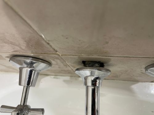

Thank You PlumbMaster-Zee and EricL for your reply and helping me with
for step by step guide. It helped to remove this stubborn spout.
and I also added Kinetic 15mm extension for flange to attach onto the thread.
now have to find a new spout in bunnings to attach to the existing thread length size , which is about 20mm
the one in Estillo kit has 15mm thread length. So about 5mm shorter.
