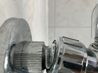

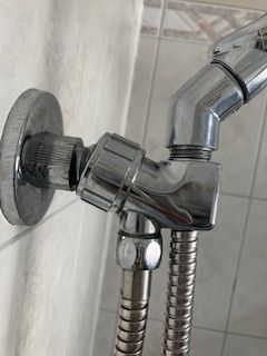

I am putting a new shower head, hose and bracket. I managed to remove all parts except the bracket that attaches to the nipple.  I can’t untwist the bracket. See the photo attached. The bracket is round and a spanner is difficult to grip to try to turn the bracket. It could also be stuck down with something…it should be a straight forward unscrew. Any experienced advice would be very helpful thanks. A plumber is another option.

You've made excellent progress in removing your shower fitting. To remove the last piece attached to your wall I suggest using a Multigrip Plier. This tool will be able to hold onto the round neck of your shower set. Please remember to turn the set anti-clockwise to remove the fitting on your wall. If you plan on using the set in another bathroom and don't want to damage the chrome finish, I suggest putting a tea towel over the fitting before gripping it with the tool.
