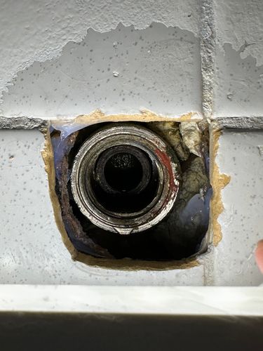

I I am going to change wall tap
hot water doesn’t have this white vale, so install very smooth, but cold water side get this one, is any way I can remove it? I have tried to use long nose pliers, but It feel stuck T_T

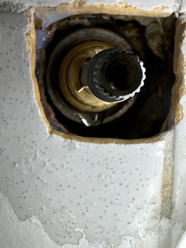

Hot water tap is fine, but cold water tap is slightly leaking as picture

Hello @dani335711
It appears that there is surface damage to the spindle seat and might require a polish. If you are keen to repair it, I propose using a Tap Reseater Indoor / Outdoor Tap Reseater to polish the surface of the seat. The general steps are to attach the reseating tool onto the tap body and turning the handle of the reseating tool in a firm light manner. There is no need for brute force when turning the handle as you will cause more damage that way. Your goal is to firmly turn the handle without applying excessive downward force, let the tool do all the work.
After several turns you can inspect your progress and see how shiny the seat is. Once you are satisfied that the seat is evenly polished you try to install the ceramic spindle again. Please do not overtighten the spindle or you will crush the ceramic disc and end up with a leak. You are after a firm tight fitting but not excessively tight.
