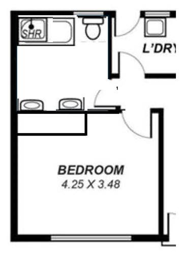

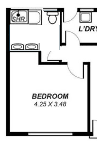

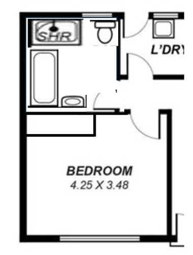

Need to bear in mind the minimum width requirement for a toilet space needs to be 900mm. So, ideally you don't wont to encroach within that measurement.
Deleting the toilet will give you a lot more space to work with, but this can affect resale. So combining the toilet and show could be an option. Stealing some space from there bedroom would also give you a lot of options.
A bedroom on the smaller side would be consider less of a negative than a bathroom. You can make a bedroom work with movable pieces, but you can't do the same with a bathroom.
Functional bathrooms, kitchens and laundries take high priority in any reno. So, here are a few ideas to get the thought processes going:
Nailbag.
