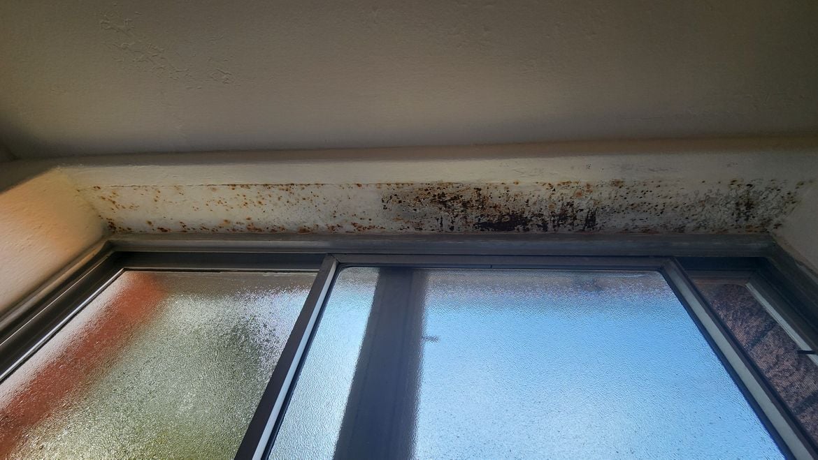

my unit's bathroom window lintel started showing rust spots roughly 6-8 months ago (moved in 2 years ago) so I decided to see take action and try to remove the paint so I could apply a rust converter followed by rust guard epoxy enamel top coat to protect it after (white knight products).

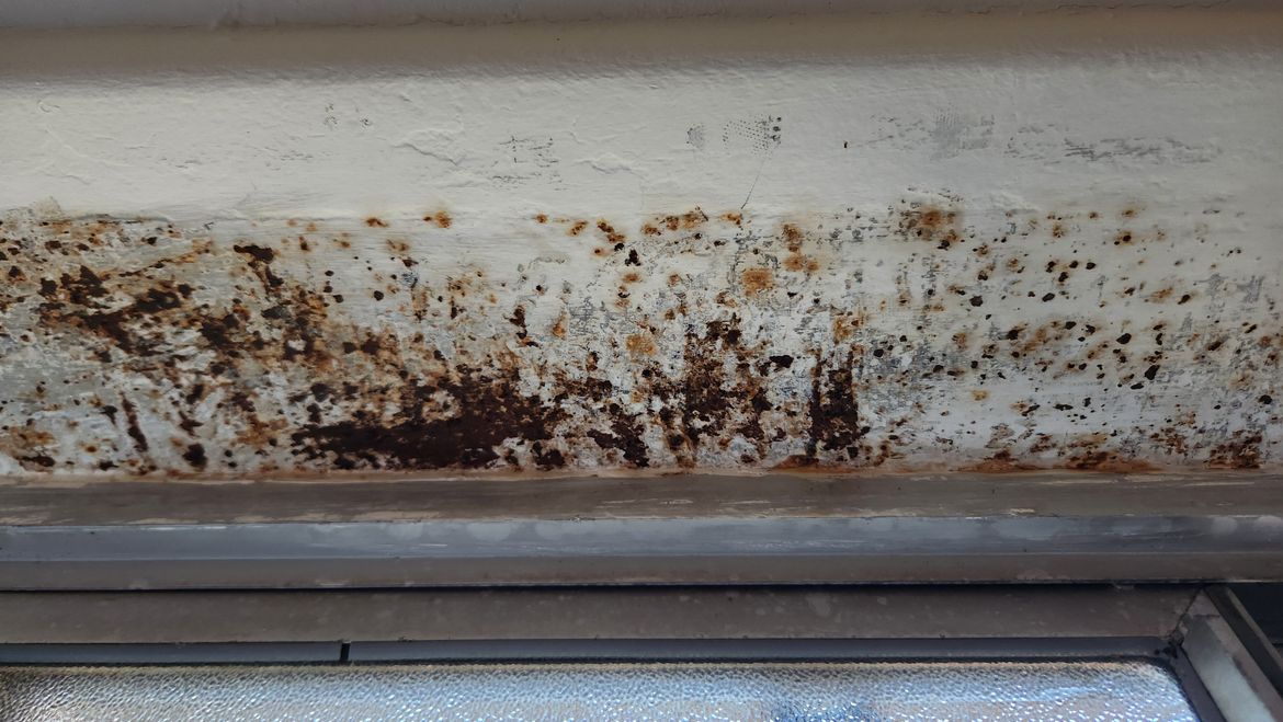

However i've been having difficulty removing the paint that is already on there. I tried to scrape it and use a metal brush but after a good 30min or doing that I barely removed a small portion of it (see pictures below, the right side is where I tried to remove the paint)
Is the best approach to use a paint stripper to easily remove the paint? I'm also a bit concerned using paint stripper indoors in terms of dangerous fumes/chemicals in a small closed space as well as smell in the rest of the unit.
Also this unit is from 1973, any chance this paint contains lead?

I suggest having a quick look at this discussion - How to test for lead paint? by @nerissa1. In one of our older discussions - How to test and remove lead paint on furniture by @GoodyG one of our members has suggested that it would be better to assume that there is lead in the paint.
In regards to using the White Knight Rust Guard system it is an excellent way to revamp and protect your window's lintel. As to the use of paint strippers, using the proper protection equipment and a filter mask should protect you from the fumes and chemicals being produced by these substances.
But I understand if you are not keen on using chemical strippers. Here is a link to WorkSafe QLD webpage on working with lead-based paints. It provides information on methods of removal that you can consider and the appropriate PPE to use. The only other option is to enlist the services of a professional lead paint removal specialist.
