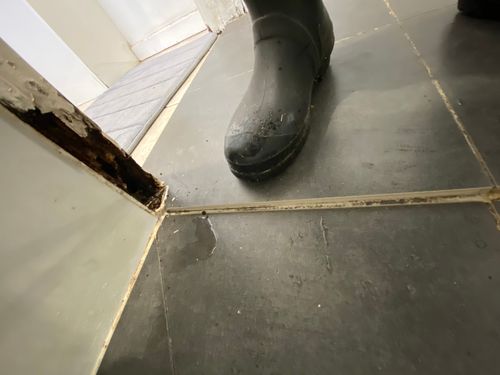

I have a shower room where the skirting/trim around the doorframe is now rotting from water damage.
Do I need to treat the existing damage and prevent further rotting of the wood? Could I just silicon the rotted area?

I think only the edge or small portion of the solid door post is damaged which I’m hoping I can just scrape off the damaged wood, spray some wood hardener over it, paint the entire door frame with waterpoofing, fill in the rotted area with silicon, and finally install a metal angle over the corner with silicon to cover the wooden part of the door frame. Any thoughts on this?

Sorry for the delay in my reply, @monkeyspearfish. That method would potentially work, but I think you need to consider repairing the section properly, which would require the damaged timber to be cut out and replaced with new timber. You can then look at repainting the surface. However, as long as there is timber in the shower recess area, the issue will likely resurface at some stage.
Perhaps you might like to replace the damaged timber and tile over the area and around the corner. You should still add a waterproofing membrane to the timber, but the tiles would go a long way to preventing water from accessing it.

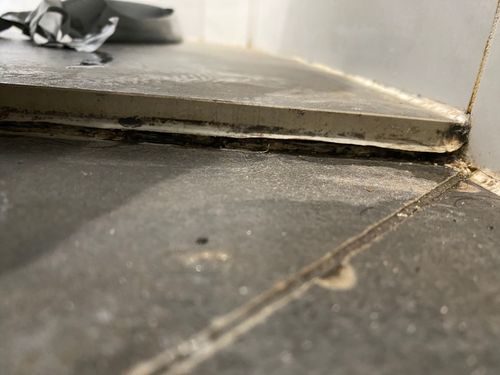

I had a plumber from insurance come out and assess the damage. He said there is water under the floor tiles, I think also due to the silicon wearing off at the lip of the shower floor (see photo). He said it’s best to rip out the floor and wall tiles and start from scratch due to poor initial design of shower room. I think it’s a bit extreme?
I’ve filled the rotted area with builders bog after drying it out for several days. Feels pretty solid now but I’m still undecided on how to patch it (timber trim vs metal angles vs tile). If I tile I will need to fork out a tiler which I want to avoid.
I’m also going to resilicon the entire shower floor corners. Hoping these patch ups will hold for the short term. I may need to consider putting in a shower screen to stop any water reaching the door frame. Any ideas for long term solution instead of ripping out everything and restarting?
@monkeyspearfish From the recent photos it looks like the tiled or shower base has moved, if insurance won’t cover the cost of repairs, you could resell the tiles with silicone, however not knowing what water damage has or is doing to the floor underneath the tiles , is it timber or concrete subfloor.
if it is timber, you could get wood rot from water damage and mould.
