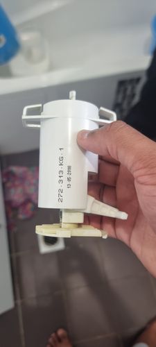

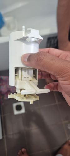

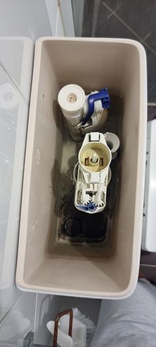

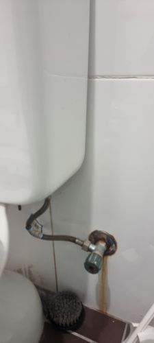

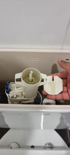

In order to give our members a better idea of the mechanism inside your cistern, would it be possible for you to remove the cistern cover and take photos of the entire flushing mechanism inside along with the inlet valve. Once we see what kind of flushing set your cistern is using, we'll be able to determine if it can still be repaired or will need full a replacement.
gkm
Re: How to replace cistern?
Thanks @EricL please see attached photos. Please suggest if we can fix it or it needs a replacement. Thank
Hello @gkm
Thank you for sharing those extra photos of your cistern. It appears you have a Geberit flushing unit perhaps a 242 model or older. I'm sorry but the store currently does not carry this unit in stock. I can only suggest using a generic replacement set such as the Kinetic Round And Oval Button Dual Flush Outlet Valve Kit. Please note that it will require the entire cistern to be disassembled in order to replace the flushing mechanism. It is a difficult and complex process, I don't recommend doing it as a D.I.Y repair. I suggest engaging the services of a plumber to repair your cistern properly.
