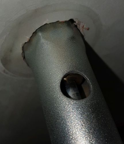

Hi to all,
I am not able to unscrew the rest of the parts to get to replace the washer for my shower tap for the fear of breaking the pipe. I tried using a mallet and tapping on the handle of the tap spanner but it wouldn't budge. Thanks in advance for your suggestions and advice.

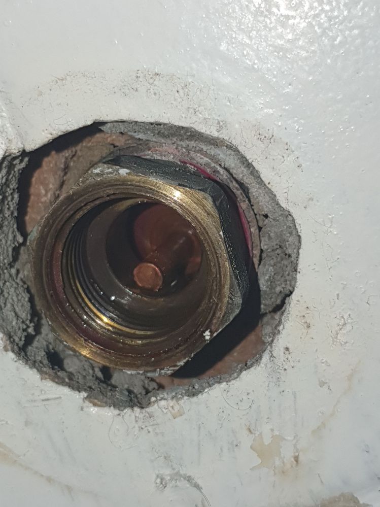

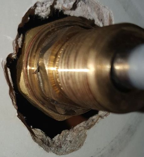

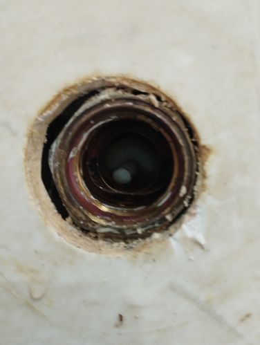

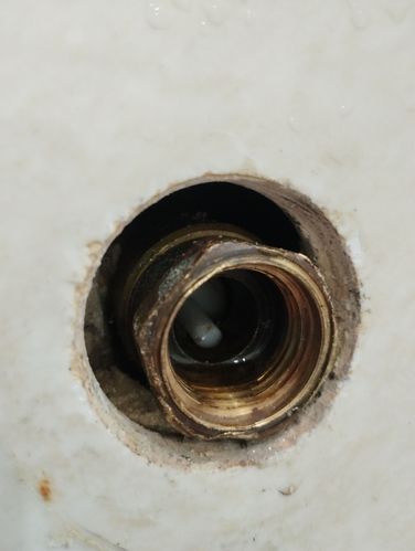

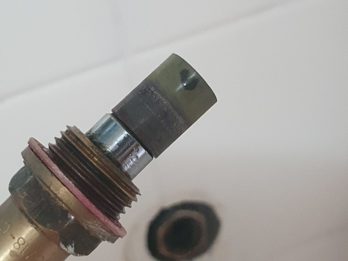

Thanks for those pictures @Thiw. The valve washer is definitely locked behind the extender.
The extender is screwed in clockwise and is removed by unscrewing it anti-clockwise. No special tool is needed, and typically, you'd use a pipe wrench. However, the front edge of the extender looks very close to the tiles there, and I suspect you'll have trouble getting any tool onto it. Does the extender extend out past the tiles so you can get a grip on it?

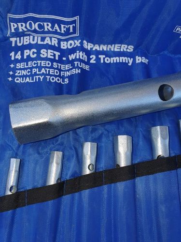

These tap spanners might not go up large enough to fit onto the extender, but they could be worth a try. The largest bit is 29mm. I'm not convinced that you'd even be able to get one of these onto it, and the tile is not cut back far enough.

Hi @Thiw
This is a toughie. First thought is to measure across flat to flat and see if there is a socket that will fit. This may turn out to be one that @MitchellMc @mentioned. Otherwise look to a mechanics socket which are available individually.
If one is available use a Kango multipurpose drill bit slightly larger in diameter to the sockets width. Then drill a series of holes around the extender to enlarge the opening to accomodate the socket and remove the extender.
If this doesn’t work, then considering replacing that single tile wouldn’t be a big concern. Unless of course one of the other community brains has better ideas.

Re: How to replace the washer in shower tap?
As per the good suggestions above.
If @Thiw applied Loctite 222 to the threads - and reinserted the spindle, and left to dry - is there a chance the extender will be removed with the spindle with the next attempt?
Before the sun sets @Thiw  - I played around with my 'extended' shower taps.
I'm sure there are many variants - but mine were easily grasped with a 30 mm tubular socket that requires only 2.5 mm circumferential clearance.
Let us know how you get on.

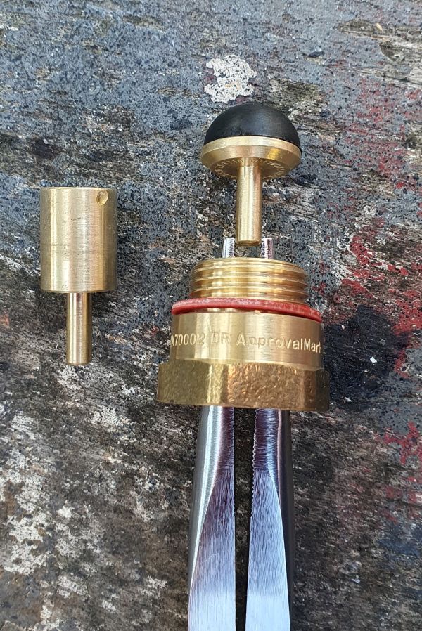

Hi @MitchellMc !
"The valve washer is definitely locked behind the extender."
Late yesterday - until I read that - I was absolutely certain you could remove the washer through the extender with long-nosed piers.
Until this morning when I was playing with a spare one.
Never doubted you for a second! 😁
So when I change my shower washers - the extender must be coming away with the spindle.
Never took notice before.
Live and learn.
