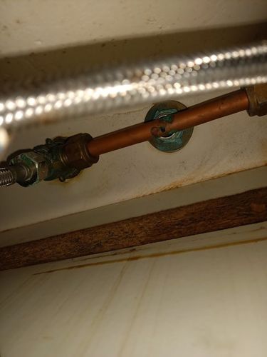

This appears to be almost identical to my situation, save that my connecting Tee is straight rather than curved (and a little longer).OZSKcCAfVdMyV.jpeg
However my proposed solution is rather different: I would like to install a mixer like the https://www.bunnings.com.au/mondella-wels-4-star-7-5l-min-35mm-cadenza-cast-basin-mixer_p5003310
However I'm concerned that a mixer has (at least) 2 incoming pipes, and so maybe needs a larger hole. I'm guessing from my photo that the spout is screwed down onto a ½inch thread, which would imply that the hole is at least 17mm, but I cannot see the hole until it's disassembled.
The installation guide https://delivery.bunningscontenthub.bunnings.com.au/api/public/content/bc377a838db34574b0e7f733f2e48... does not mention the size of hole that should be cut.
Any guidance on either (a) expanding the hole in the sinktop, or (b) identifying which mixers might fit, would be appreciated.

Hi @redracer01
Thanks for your reply.
I already have all the items shown, except the pipe cutter and compression unions.
It's not clear to me why I would need those, but perhaps I didn't explain well enough: the taps are currently fed by (braided flexible) hoses, which are visible in the foreground of my picture; the only rigid pipework is the mixing junction between the taps, which I intend to remove along with the taps and spout, and the in-wall pipes, which I'm not changing.
I've bought a Mandella Cadenza mixer  (https://www.bunnings.com.au/mondella-wels-4-star-7-5l-min-cadenza-swivel-basin-mixer_p5003380) which has a threaded shaft of about 30mm and a base of about 50mm, but the O ring underneath is set in by a few millimetres and that would be the limit for how large a hole I could drill. (That said, if the hole is large and slack, the tap could slide so far off-centre that the O ring won't seal, so I will use the smallest cutter I have available.)
When I've drilled using a hole saw before, it has had a long guide bit in the centre, which obviously won't help if I'm expanding an existing hole; so am I likely to encounter any problem with "drifting"? (I don't want to wind up with scratches on top of the bench around the hole; even if they're not visible, they may compromise the O-ring seal.) I'm using a battery-power drill/driver, so "take it slow to start" is obvious, but is there anything else I should do to counteract drift when starting the hole?
I will use a rasp to check whether the basin is ceramic before drilling.

Re: sink taps
Hello @DIY-Dilatante
My apologies for not looking at the photo clearly. You won't need the compression fittings or the pipe cutter. When assembling the basin mixer just remember not to forget the o ring for the bottom of the tap. From the bottom end of the vanity the rubber goes first before the steel halfmoon washer then the last will be the nut. Tight enough that it's firm but not overly that it bends the washer. The base of the tap must be centered to the hole so that the rubber grips the vanity top and not slide around. The rubber at the bottom grips the underside of vanity and prevents the washer from sliding around. Goodluck and stay safe.
As for the drifting you can temporarily wedge or fix a piece of timber under the old tap hole. You can screw it to the wall temporarily. Put a pilot hole dead center of the old tap hole. Now assuming your using a drill guide for your hole saw you should not have any trouble drilling center.
